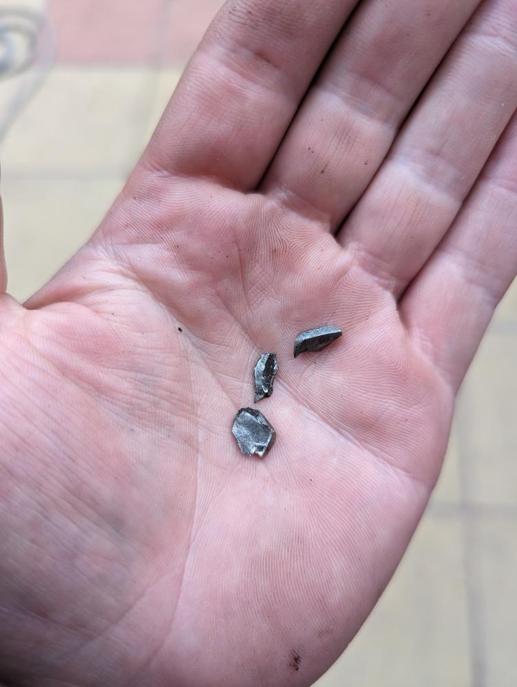

Second job while I was around the rear axle was an oil change. Unfortunately among the sludgy oil was this:
The crown wheel isn't obviously missing any chunks as far as I could see so presumbly the pinion is the culprit. I hadn't really factored in an axle rebuild so this definitely isn't ideal. The axle is a bit of an unknown so I don't know how recently any damage would have happened or what the underlying cause is. I'm assuming with chunks of metal that big in the oil it's fairly terminal and total failure is a case of when rather than if!

(16-07-2023, 07:55 PM)RupertW Wrote: I'm assuming with chunks of metal that big in the oil it's fairly terminal and total failure is a case of when rather than if!
Rupert, stop driving the car and investigate it now while (a) you are safe and sound at home and (b) bearings and diff carrier may still be serviceable.
