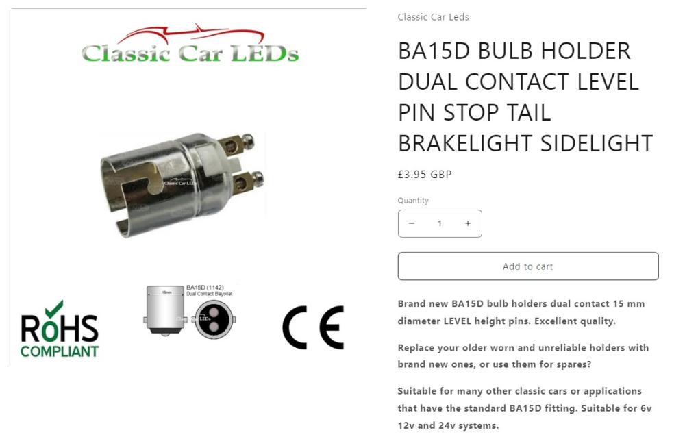

On my 1929 Chummy, the 6-volt headlamps have a single contact bulb holder and to fit one of the new high/low beam bullseye bulbs, they needed changing. I bought a pair of new double contact BAY15D type holders from Classiccarleds.co.uk and set about fitting them.
I turned up a bar that was very close fit in the bulb holder and held this in a pair of very soft vice jaws - the bar preventing the bulb holder from being compressed and allowing me to carefully bend back the tabs holding the white "contact unit" (seen in the picture) and extract it. Of course, the unit is not a drop-in fit into the original holder but has to have two opposing bulges very carefully ground off - it's not a soft plastic but surprisingly hard stuff.
Once the side retaining tabs on the original single holder had been bent back it was extracted and the new unit dropped into place.
