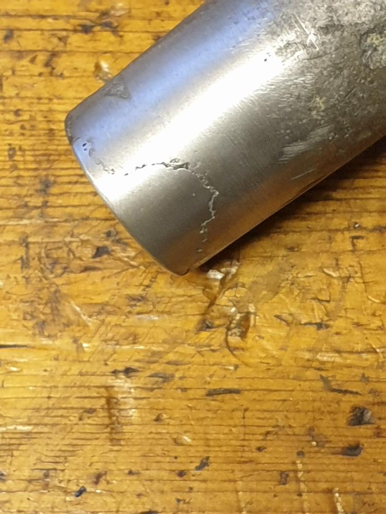

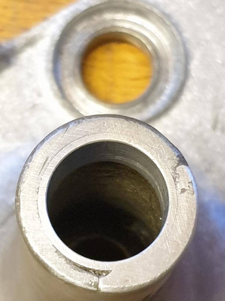

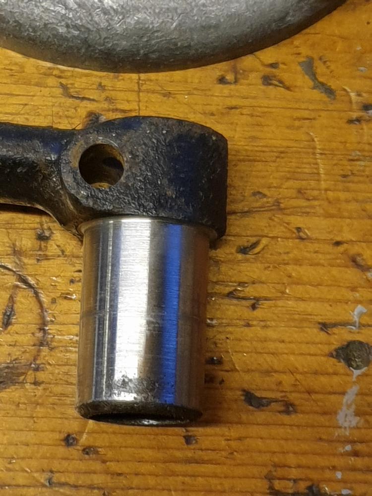

Spent a bit of time this afternoon repairing a broken front cover. Dressed the weld back and bored to clean. Turned off the wear on the starting handle and fitted a new aluminium alloy insert in the nosepiece to suit. Dressed off the outside weld to clean.
As they say in Yorkshire "That'll do!"

Do you have a giant lathe to turn the crank handle shaft or did you use some sort of internal fly cutter?
Hello BC,
     in fact I have two giant lathes and a boys lathe, plus a 1912 Drummond round bed treadle.

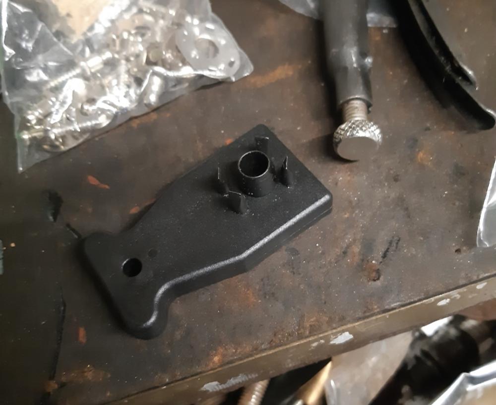

I decided I really should get my finger out and fit the mail order hood bag. It needed the lift the dots fitting, so did that. Once the postage (and storage) creases come out itll look very nice. Certainly better than a flappy hood.
This thing was ace, with a lump of wood and a g clamp
