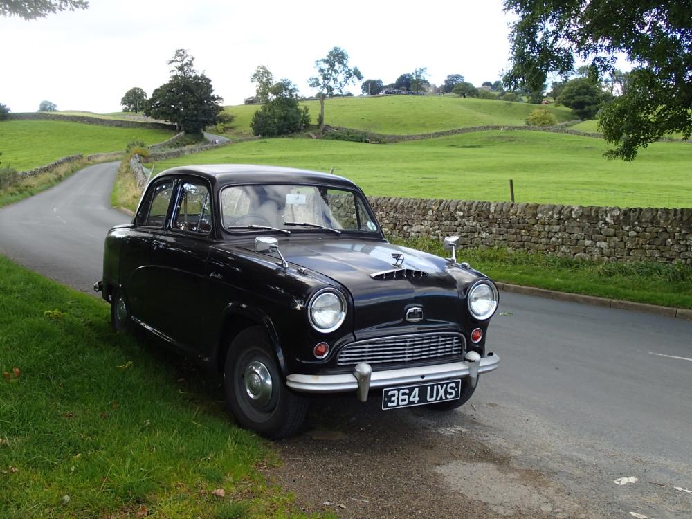

(26-01-2022, 07:50 PM)Bob Culver Wrote: Intrigued by the stone walls. Had a few in some places here but smooth river stones, not so stackable.. Most now been sold for crushing for concrete.
That type of dry stone wall is extremely common in Yorkshire and in many other counties.
