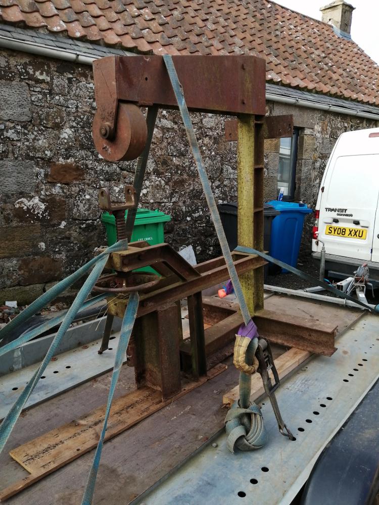

At the end of last week i found this "Press" listed on market place for next to nothing, so headed over and collected it yesterday - As you will see its agricultural spec but is very sold and well made, but sadly the bottom roller / anvils are missing but iam sure i will turn some up online if i start looking, does anyone have any ideas where best to start other than Ebay?

Hi John D
Assuming you have a lathe scrap merchants will often sell odds and ends. Curious that the lower roller so much smaller., unless there were two in a cradle. For a larger roller many brake discs have a heavy cupped centre. Two could be keyd and bolted together. Brake firms have scrap piles.
That looks like a homemade English wheel JohnD.
You can buy whole sets of bottom anvils relatively cheaply for making your own wheeling machine, you may need to alter the lower cradle slightly to accept them but otherwise straight forward.
If you plan to use that machine for wheeling you'll have a job polishing that top wheel! Mirror finish is generally what is recommended. For anvils there are several eBay sellers, some of whom will make to order...
Ive had a look through ebay, and think the way forward will be to buy a set of Top and Bottom wheels and change them over onto this frame - then i just need to spend a few nights on youtube learning how to use the thing!
It'll take more than a few nights on YouTube! I've had a wheeling machine since 1998 and I'm still learning although I use it regularly. It can be astonishing how much difference a couple of thou' makes over the area of a panel.
I was given to understand that the apprenticeship for this machine alone is up to five years, working with an experienced wheeler
