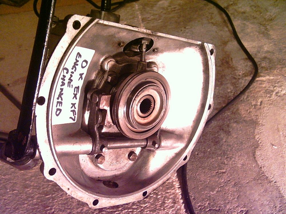

I remember an article years ago about how to fit a 4 speed release bearing to a 3 speed gearbox, does anyone have a copy to hand they could post or give advice on how it's done. I guess I need to somehow clip the release bearing to the release arms and put a return spring on the clutch pedal somehow? Many thanks in advance all.

Fit the hammer head type release levers to the clutch pressure plate, swop the 3 speed release Assembly for the 4 speed release assembly, job done

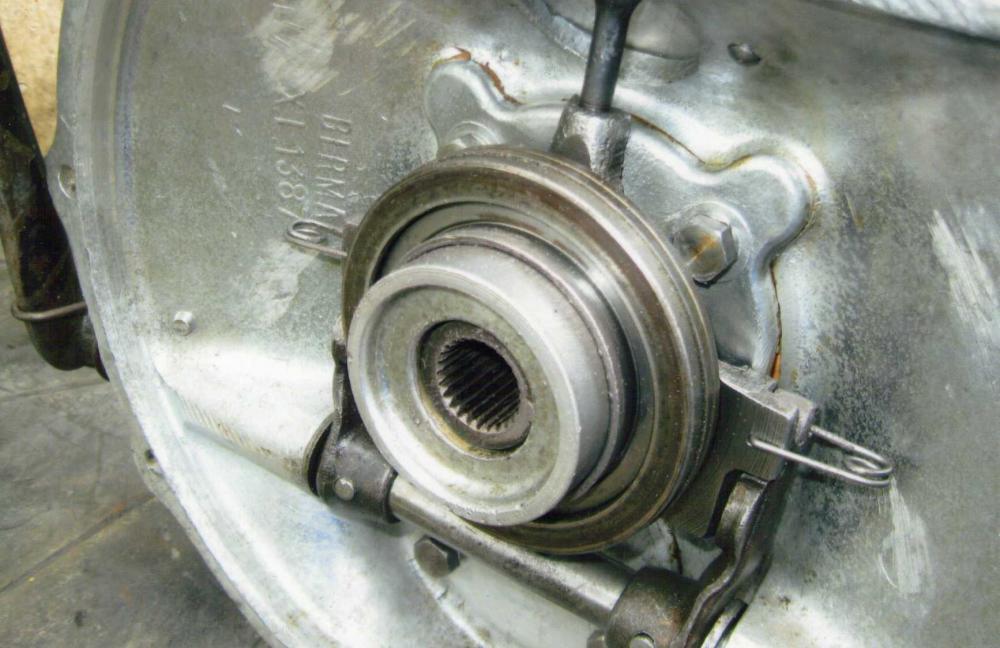

Many thanks both, I think the hand done drawings are what I remembered, potentially in the BA7C newsletter many years ago.
Zeto, do you not have any way to pull the bearing back or do you just let it be pushed back by the clutch levers? I was worried about it disengaging with the cross shaft levers and turning a bit thus loosing location on the two flats?

I still have the spring on the clutch pedal which keeps the levers in contact with the release bearing, and the bearing stays in contact with the 3 levers on the clutch pressure plate.
Fitted new levers from Sevenworkshop and have a very nice clutch with slightly more travel.
Does anyone know if the new levers have the pivot point in a slightly different position
as my clutch is a huge improvement with only fitting those levers, no new clutch.

I think the pivot point on original three and four speed toggles differs between the two type and all reproduction ones differ again from those.

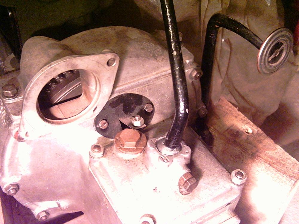

It look s as if the gearbox lid is on back to front in the last photograph.
