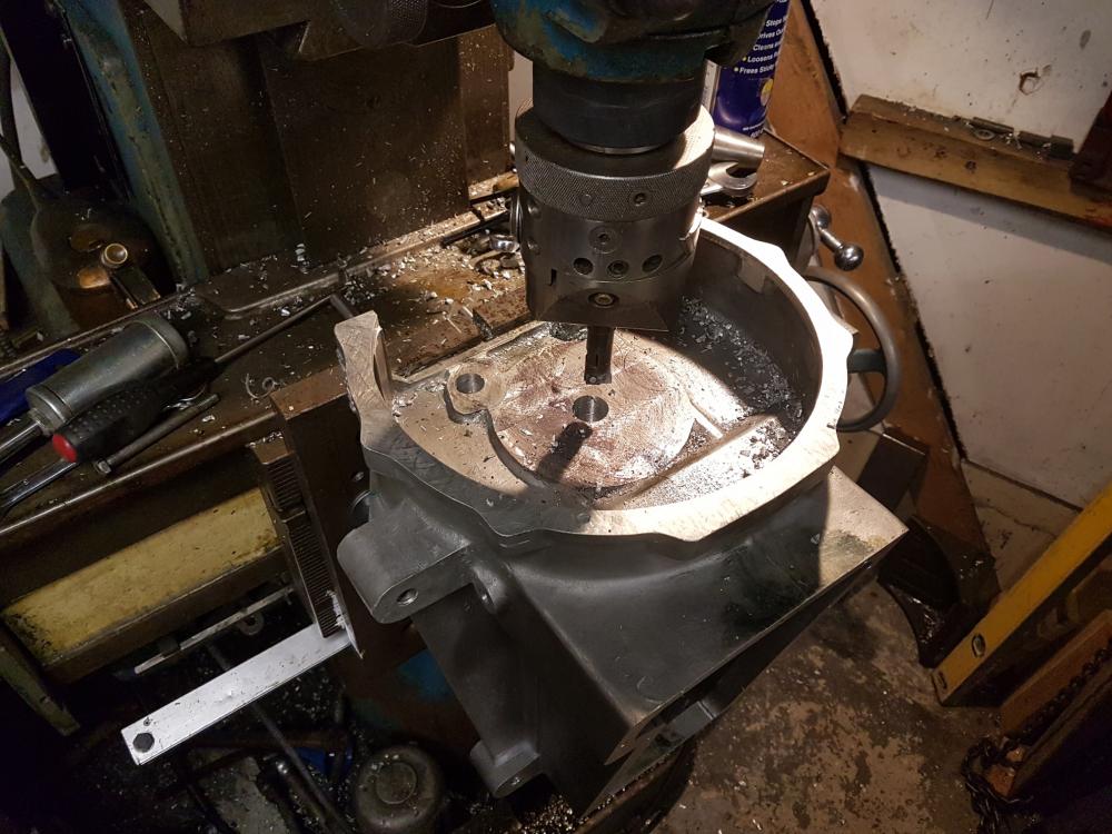

On a brighter note I've been boring.
Let's hope that the holes are in the right places!
Charles
Nerve wracking I imagine Charles, you don't really get a second chance!
(29-02-2020, 09:35 PM)Ian Williams Wrote: Nerve wracking I imagine Charles, you don't really get a second chance!
You do if you plan for it!
Both bores will be undersized so that I can insert a test bar and check alignment and perpendicularity whilst  leaving a chance to correct
Charles
Yes of course excellent thinking!..........I knew that Smile
Looks like a job for final cut on a line boring machine.
I’ll bet a lot of time has been spent planning and thinking this through.
Have you practiced on an old plentiful case
