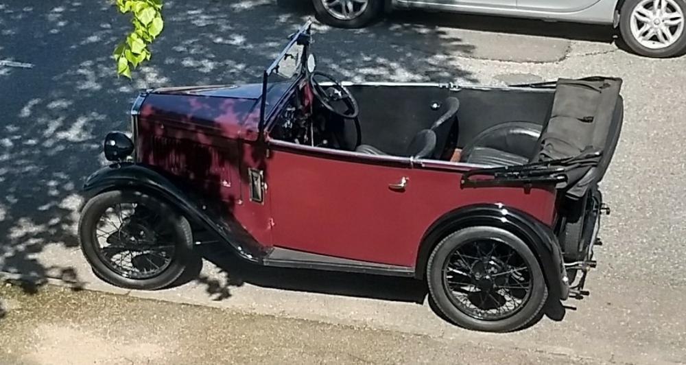

APJ273 in the summertime
I had my first topless trip in a sunny Aberdeenshire with my AJ tourer since Ruairidh did a complete rebuild of the engine. The engine is so much more responsive and willing with a lovely sound which is definitely best appreciated without the roof!
Thanks for a great job Ruairidh
Ian
