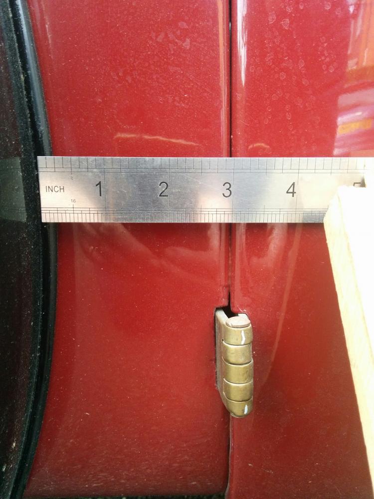

I think it will be immediately obvious if the doors don't fit; the question then is whether the hinges have dropped (in which case gently lifting them may rectify any gap) or the sills have failed, or both.

Thank you Both Just the info I was looking for, particularly measurement Colin. Hope its just nice new hinges that are needed. love that door fit in the pic, would be happy with that. Rob

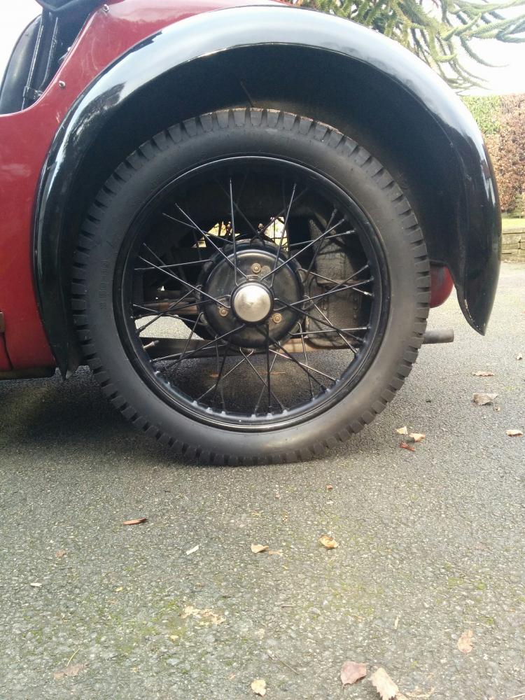

The gap on mine from door line to mudguard is 3".
I have often wondered if mine is right as the wheels do sit forward in the arches. If the arch was positioned 1.5" further forward the wheels would be centered. On mine the wheel arches line up with the back of the body.

Assuming Austin wanted rear wings central to axle because thats what the 1933 plan suggests (but didnt actually properly achieve it until the later Nippies, when the wings changed subtly) the only other option after "that" panel being smaller is the body moving forward.. so you can assess that in relation to the starting handle nose piece, steering wheel gap and so on.     You can see here the 1933 test car image, admittedly from a poor angle. That panel is narrow, but even then, the finished wings weren't of a radius to allow the 65 to be visually as per drawn plan.     By 1936, they were!
(11-01-2019, 01:22 PM)JonE Wrote: best not to get too obsessed over it like I did...! But worth re-reading this https://aus7in.wordpress.com/2018/11/17/...n-and-fit/ if you ever have to sort one out that plainly needs repair.
The rear wings are in a different position from side to side, one is further back than the other, don't know how they managed to do that
which images zeto? (The two above are entirely different cars - 65 from early 1933 and later Nippy with tighter radius rear wings from 1936)
There are distinct differences in the B pillars between the red car and the white car in the photos posted. The white car has a much narrower vertical part between the hinges and rear wing, but more importantly the horizontal part rearwards of the door opening appears shorter and the upsweep looks to be more acute. As has been said unless yoy know for certain that the car hasnt been restored then its all anecdotal.
