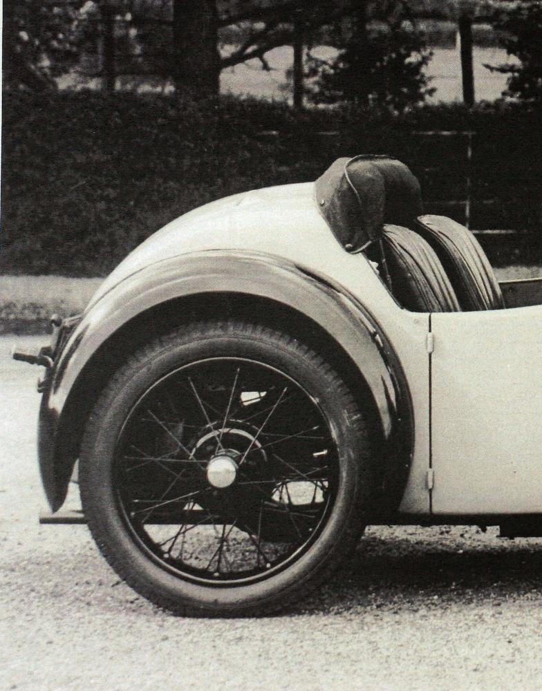

best not to get too obsessed over it like I did...! But worth re-reading this https://aus7in.wordpress.com/2018/11/17/rear-wing-type-position-and-fit/ if you ever have to sort one out that plainly needs repair.
Assuming Austin wanted rear wings central to axle because thats what the 1933 plan suggests (but didnt actually properly achieve it until the later Nippies, when the wings changed subtly) the only other option after "that" panel being smaller is the body moving forward.. so you can assess that in relation to the starting handle nose piece, steering wheel gap and so on.     You can see here the 1933 test car image, admittedly from a poor angle. That panel is narrow, but even then, the finished wings weren't of a radius to allow the 65 to be visually as per drawn plan.     By 1936, they were!

RE: NIPPY DOOR OPENING. - JonE - 11-01-2019
which images zeto? (The two above are entirely different cars - 65 from early 1933 and later Nippy with tighter radius rear wings from 1936)
RE: NIPPY DOOR OPENING. - Reckless Rat - 11-01-2019
There are distinct differences in the B pillars between the red car and the white car in the photos posted. The white car has a much narrower vertical part between the hinges and rear wing, but more importantly the horizontal part rearwards of the door opening appears shorter and the upsweep looks to be more acute. As has been said unless yoy know for certain that the car hasnt been restored then its all anecdotal.
