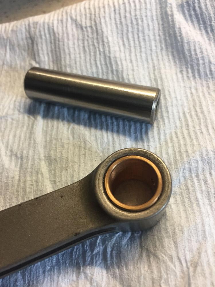

(23-10-2018, 07:37 AM)Ruairidh Dunford Wrote: Simon,
in your shoes, I would be looking to source another rod.
However if you do proceed as discussed above, remember you will need clamp type gudgeon pins.
At the moment we don’t know what rods Simon has, but yes obviously clamp type for clamp type rods but others have converted clamp type rods to fully floating by inserting an appropriate thickness of packing in the slot and boringe the hole.This was done to use The Honda pistons,we don’t need to do that now as Tony does the slipper pistons.
Simons question was where to get oversize pins, it has been answered.Simon can use 13mm pins, if he has clamp type rods he can grind,or have ground the clearance in the middle of the pin for the clamp bolt.Another rod was suggested early in the thread, clearly he does not want to do it that way.
If the rods are suitable for floating pins I personally would have new bushes made up for the little end eyes - I had to do this very recently to convert back to standard pistons from Honda ones.
(23-10-2018, 08:21 AM)Ruairidh Dunford Wrote: If the rods are suitable for floating pins I personally would have new bushes made up for the little end eyes - I had to do this very recently to convert back to standard pistons from Honda ones.
Interesting, why didn’t you follow your own advice and just use another set of rods.It leaves them weak,You have to take out more material in order to bush them.
The rods were fitted with bushes to suit the 13mm floating pins of the Honda pistons.
We simply removed these bushes and made up new ones to suit the 1/2” standard sized floating pins.
There was no need to replace the Pheonix rods as the o/d of the bushes was identical and the little end unchanged from the way they were produced.
I do like the way a simple question gets all sorts of subsequent information out into the open.

(23-10-2018, 10:40 AM)Ruairidh Dunford Wrote: The rods were fitted with bushes to suit the 13mm floating pins of the Honda pistons.
Sorry Rory, thought you were talking about Nippy rods just goes to show, one needs all the info before making a comment.Just fine to rebush where there were bushes originally.
I would be interested in the Honda pins if unworn.
Best Wishes Gene

Honda pistons although high quality were never ideal because the compression height is too short meaning that compromises were made, the top and bottom of the block was skimmed, top of crankcase skimmed, .010” off all 3 surfaces and often no block to crankcase gasket.
No need to go to all that trouble now as slipper piston are available from Tony Betts, these are good for road/ standard engines as well as racing.Available sizes 56 through to 57.75mm, fully floating or clamp type pins          either type pin are .5” diameter.
What type rods do you have? Are you the Simon who has a Cambridge special?
