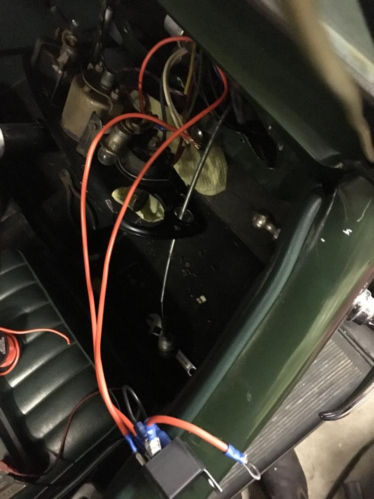

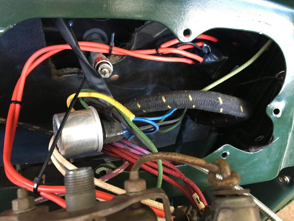

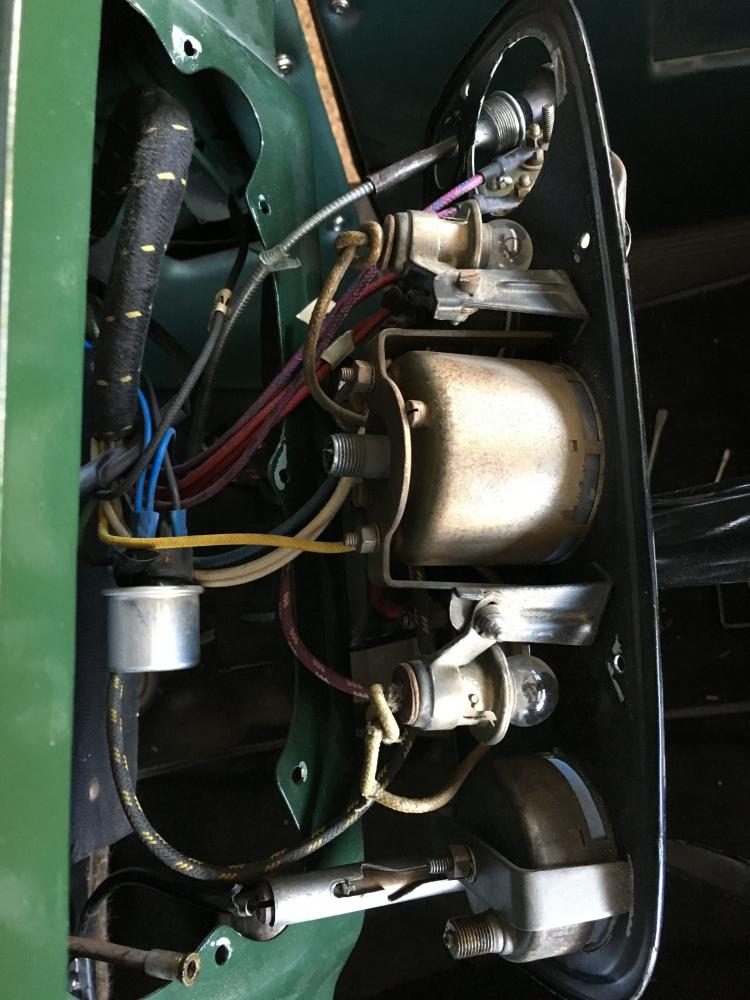

Dash moved out to access the switch.  I disconnected the speedo, oil pressure gauge, and loosened brackets for starter cable so it could move out far enough.  The wire soldered to the warning ligh was only hanging on by a few threads so I removed it and attached a longer wire to go to the new relay that is required for positive earth dynamators.
Last photo shows new shiny red wires added to attach the relay.  They will all be tucked up under the dash and out of sight.
I also took the opportunity to fix a long term issue where the tail lights only worked when side lights were on.  I needed to move the red wire that I had attached to L to join up with the other red wires at T.
My fuel gauge has also not been working so I tested it while off the dash.  Direct 6v sentbit straight to full so I either have a wiring or sender fault.

Re fuel gauge problem I suggest you check the Earth on both gauge and sender.
John Mason
Thanks for the tip re the fuel gauge. There are a few different wiring diagrams around. The one I originally used only had two wires to the gauge. I found another diagram that has an earth wire as well. I attached an earth to the gauge and it sprang to life.

Relay for warning light fitted neatly in behind the dashboard.

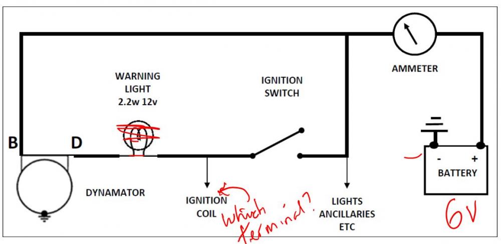

Here is a basic version of dynamator wiring diagram for cars with 6 V positive earth, a late model switch  and incorporating the relay.

I've searched the forum but don't see anything for this specific problem. Attached is a copy of Vince's wiring diagram that I used with a couple of edits.
Any ideas on what I have wrong?
