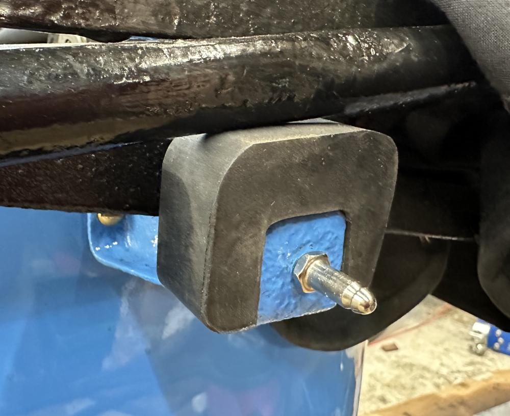

Instead of a piece of old tyre, a slightly better-looking solution might be a rubber block that some of us have used to fit on hood-support brackets, like these. Perhaps with a half-round slot filed oor milled across the middle - to register against the curved end of the spring - it could be 'squeezed' into place and so held securely?
Tony you have reminded me. A long time ago, probably nearer to 50 than 40 years, I acquired a box of sundry Austin 7 spares. Apart from the nippy gearbox and carburettors were several figure of eight rubber blocks, exactly the right size and shape. Should still be there somewhere but I suppose the rubber has perished.

(11-03-2025, 10:08 PM)Alan Wrote: Tony you have reminded me.  A long time ago, probably nearer to 50 than 40 years, I acquired a box of sundry Austin 7 spares.  Apart from the nippy gearbox and carburettors were several figure of eight rubber blocks, exactly the right size and shape. Should still be there somewhere but I suppose the rubber has perished.
Alan, might you have some pictures of the 'figure of eight' rubber blocks - and their dimensions? I'd be very interested to see what they look like.
