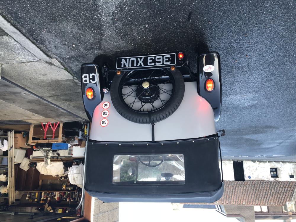

To cold and damp with lots of sea spray in the air but took the tourer out for a quick
run round the block.
Noticed the side lights (front and rear) and brake lights were on. All off when I pulled the
actuator away from the brake switch.
So another puzzler to fix when I have stopped putting pound coins into the swear box !.
Did this before and never found out why. Hope it does not go away this time so I can
sort it.
Hi
It could be that the brake lights have lost their "proper" earth and the current is returning instead via the sidelights. A manifestation of the "trailer board" effect.
John,
Looks like the problem is with using LED's for the brake/stop lights.
Put the filament bulbs back and worked as should.
So this afternoons job is to add some 'pull up' resistors across the lamps.
Sort of defeats the object for using LED's as current draw will be higher.
Also found the brake switch has gone sticky, so something else to do and
at a guess another £10 in the swear box !.
You might well find that if you install perfect earth connections from lamp holders to the battery earth point you will not need resistors or anything else. With LEDs current draw is so low that a slightly poor earth causes different voltage distribution.

Regarding LED stop and tail lamps. The ones from some suppliers consist of a single LED, with two different value series resistors to give a high current for stop and a lower (= dimmer) current for tail. That's all fine and dandy, but there is an increased chance of backfeeding and odd effects with this simple setup, especially if the car has a mix of LEDs and filament bulbs. In my setup, I resorted to adding series diodes in the wiring to prevent back feeding.
Another effect is that if bulbholders are not in the first flush of youth, their slightly tarnished connections may work fine with filament bulbs as the higher current tends to "wet" the contact. I'm uncertain of the exact mechanism, but possibly a bit of micro-arcing burns through the tarnish. If you use lower current LEDs contact may become less reliable, especially if the "bulbs" have hard nickel contacts rather than the traditional more accommodating soft solder. The cure is thorough cleaning or using new holders.
