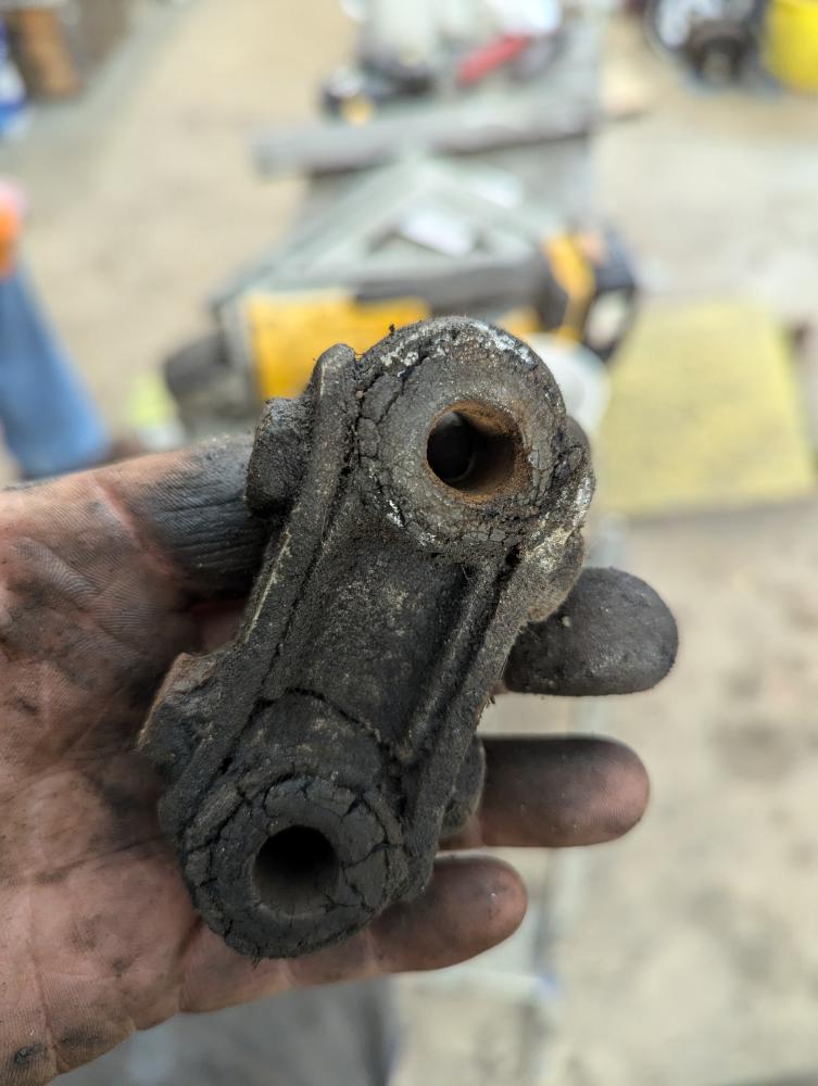

Started to change this a few weeks ago and when removed the spring pins broke, so this weekend, with new parts received this was finally changed
Amazing what people had to repair before we had the cherished suppliers working hard to supply these parts
My Ruby had had one of these rear links replaced with a piece of flat steel, about a 1/4" thick, drilled for the bolts. They dispensed altogether with the rubber bushes.
Jamie.

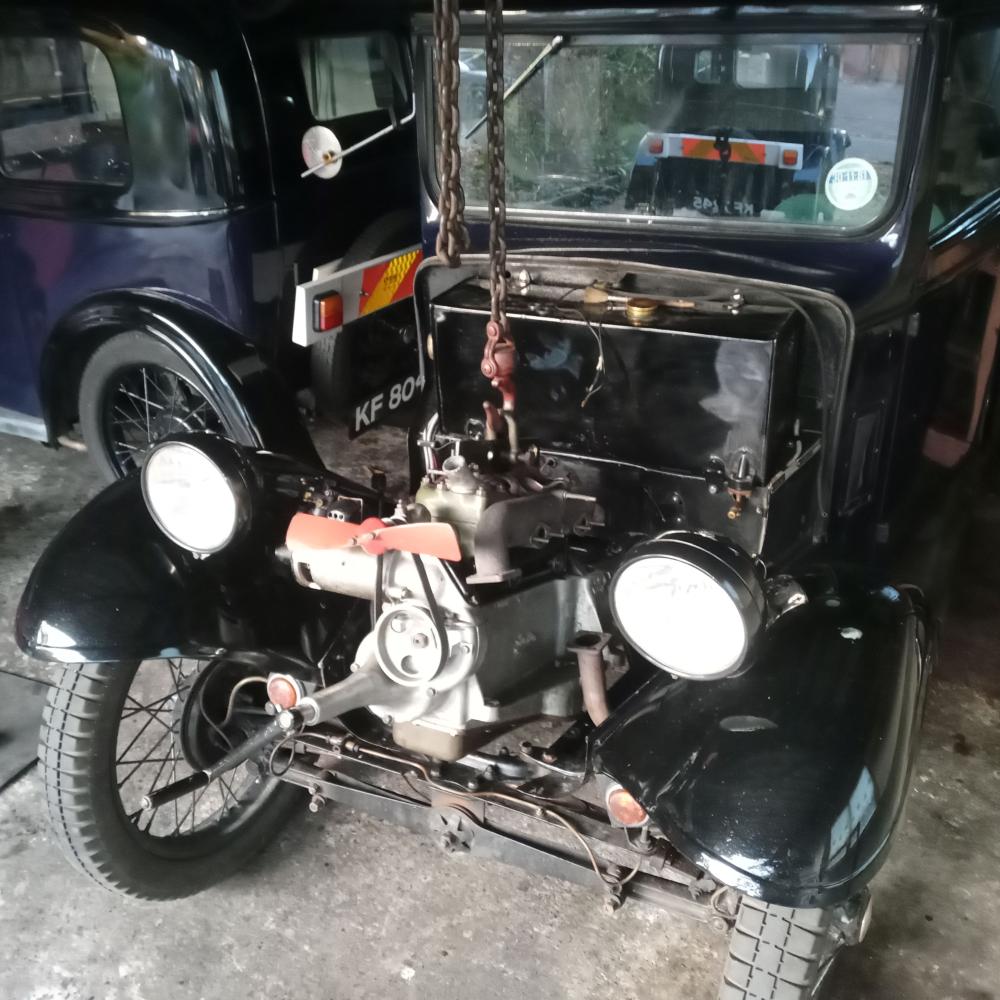

Fitted the spare engine to one of our cars because it has developed an appetite for oil and and the block/crankcase paper joint has failed after 25 years and 60,000 miles. For those that drain the engine cooling system for winter I drained the engine after a run when it was hot as I didn't want the removed engine lying around with wet cooling passages a breeding ground for rust. By the time I had removed the radiator I could see in the water outlet that the cylinder head internals were dry.
From whom did you buy that paper gasket?  After so few miles and so few years you should ask for your money back!
