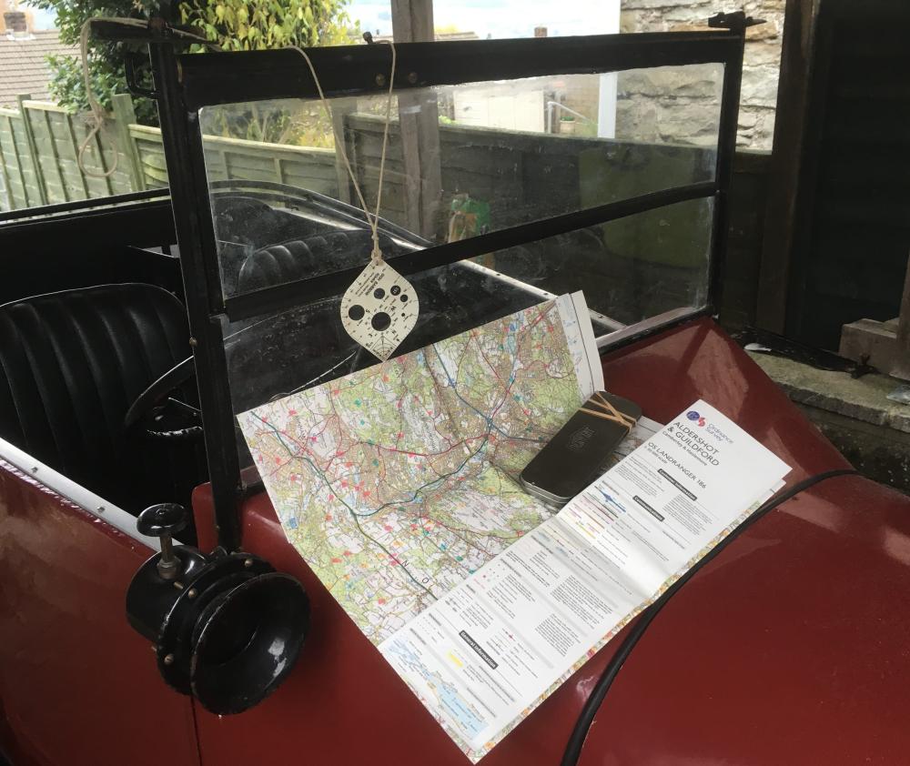

What has to be done today is eager preparation for tomorrow's Inter Reg Nav rally. Fear not Sevenists, your team will continue to chase the Inter Reg Shield, we are but three points behind Abingdon so all efforts will be made. Across the hills and heaths of Surrey routes will be plotted, possibly across golf courses. Accurate time keeping is vital, so no stops will be made for a quick pizza in Woking, stop sniggering at the back there. Tops of tables are nearly ready, spot heights marked and pencils sharpened. Organiser Philip Bayne Powell has yet to reveal the entry list, although PWA7C competition chief Rob Rhodes may well be taking part.

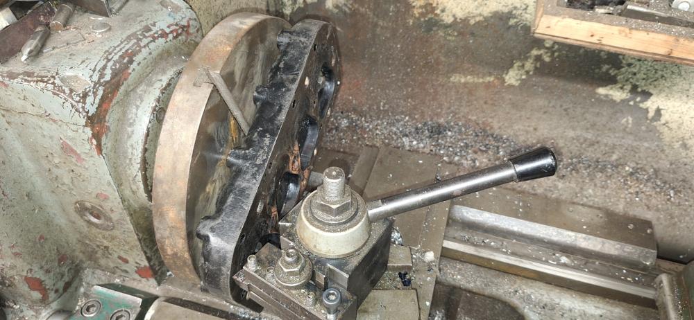

A little head machining underway
Hi Charles,
Is that a Ruby head set up for wedging it or is it a straight skimming job.
(05-11-2024, 06:55 PM)dickie65 Wrote: Hi Charles,
Straight skim on a Ruby head with enlarged chambers.
Bit of a challenge to wedge a head with this set up!

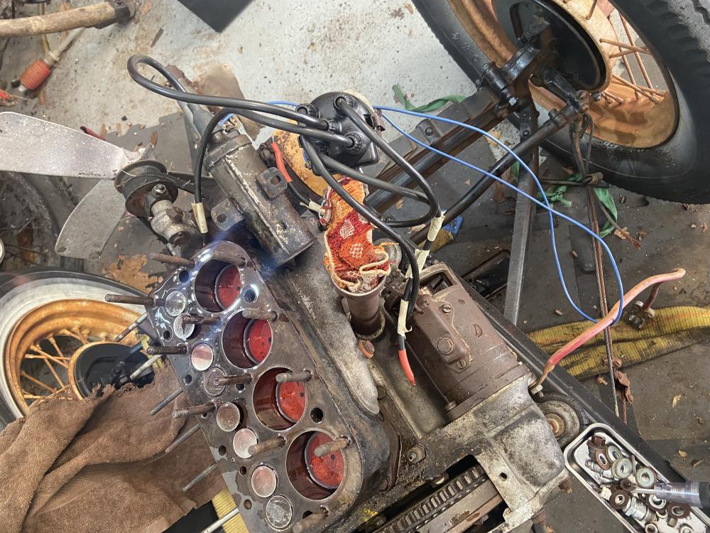

I am posting from sunny New Jersey. I may have mentioned before that I picked up a chassis and engine from Connecticut this Summer. In the process of tearing down the engine to find out if it’s a runner with not too much effort. Look at the attached picks. When I took the head off I see that some of the valves have been replaced with Ford (USA) valves. Anyone heard of this before? Can I use these as replacements?  I am super curious.
All the best
Chris Law.
