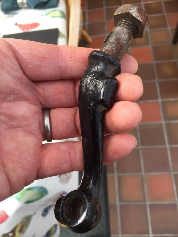

Hi R,
That looks like 9C to me, with some left over cast in the curve of the C?
I must admit I've had plenty sports axle in, but never looked for the 9E or 9C stamped on them.
But they have all been embossed with a 1A number.

It could be - I gave this particular arm to a friend - he may be able to clean it up better and get a clearer shot.
