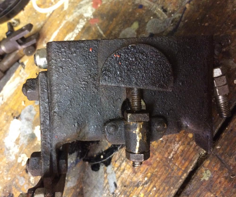

Rubies running about smoothly and reliably are jolly good, but time for a little wrestling with a Chummy in the workshop. And today's dreadful discoveries are discovered dismantling front brakes. It really is a job to know what to say. Quite a lot of  Parts List p.32 now needed, but so far no cherished support worker has got any relevant bits. Back to the phone, then.

I think you may be having to phone someone who can make the bits rather than supply them.  Your lucky you have the adjusting quadrant   I had to make mine ?. Fortunately I had one on the RK to copy.
Seven workshop have the pivots which may help?
Our cherished suppliers, whilst pretending to have better things to do in the evening,  do indeed look at what we're up to on the forum. Sometimes this results in a stern telling off on the phone. In this case it resulted in certain parts being dispatched, my mechanical ineptitude having caused me to incorrectly describe them. The supplier is a modest chap who never boasts, but suffice to say that whilst the bits arrived almost before I knew they had left certain shelves, if they had taken a maritime tour, ending coming up the Mon & Brec Canal but beginning by going down the North Walsham Canal, they would still be days away. Thank you Jamie. Now that the temperature has soared at least one and a half degrees above zero, its down to the workshop to put the brakes back together.
The problems with the early handbrake mechanism are not always limited to the pivot pins but also afflict the holes in the bracket, which are usually worn very oval. I usually braze them up and re-drill, giving a bronze bearing surface if done carefully. Can be a fiddle though.....

I welded the holes in my bracket and then drilled them.
