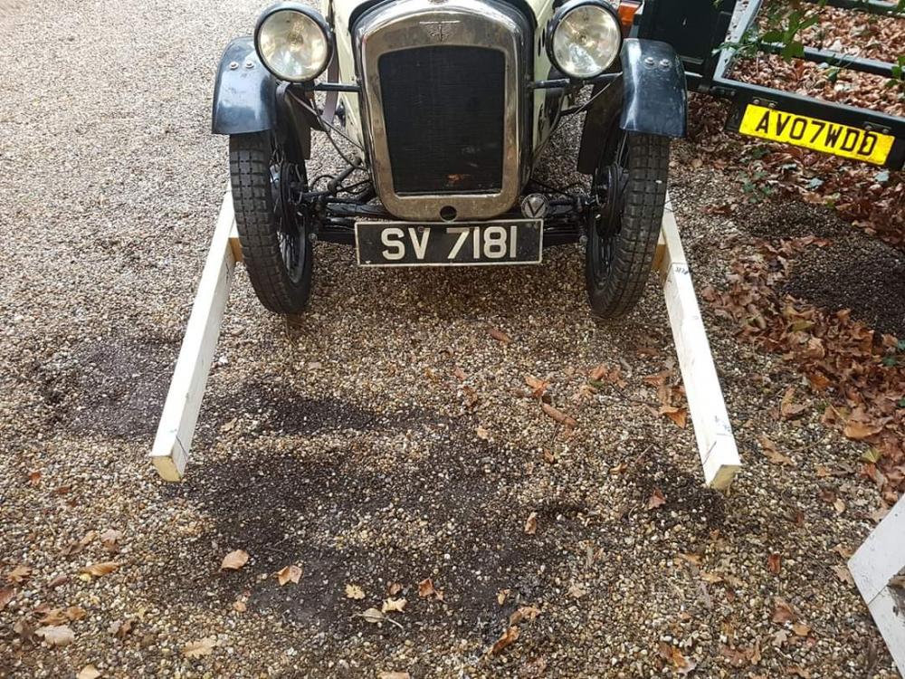

Next job is to set the toe in. Ill clamp a couple of bits of wood on the outside of the tyres and take it from there. Im not taking the axle off to do it off the car
(07-06-2021, 06:17 PM)Hedd_Jones Wrote: Next job is to set the toe in. Ill clamp a couple of bits of wood on the outside of the tyres and take it from there. Im not taking the axle off to do it off the car
You mean like this.
I made them rest on the rims, but same idea.
You can just see the felt marking on the projecting wood to allow for some trigonometry
I had to cut some extra thread to get the right toe in.
2" of toe in did make it handle rather like a hovercraft
You mean like this.
c
Exactumundo like that.
I've done some painting on the roller on my return from Essex, so didn't want to move the Fordson out of the way to construct something on the front of the RP.
I am hoping that I dont need to cut any more thread, I've got a good 1/4 extra by other means but we shall see.
