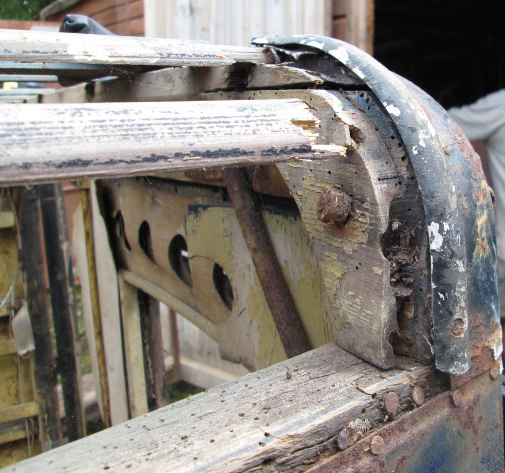

(19-08-2019, 06:27 PM)Martin Prior Wrote: Mike - Sssh!  I realised as we loaded it into the van that we'd forgotten the ventilation holes!
 I missed that, we'll have to put them in this end then!
 Fantastic Job Mr Prior, very happy customers this end.
Actually, I think there should be four ventilation holes in each back door - at least according to contemporary Austin advertising literature.
The door linings I replaced on my own AVJ also had four, but I cannot vouch for their originality!
PS - Congratulation, Martin, on a wonderful piece of work.
Rick
In deepest Norfolk
Rick, you may well be right - I'm relying on fifty year old memory!
Rick's correct.
Not a great picture, but this AVK is the newest known surviving Austin Seven.  The original door card, with four holes, is clearly visible.
