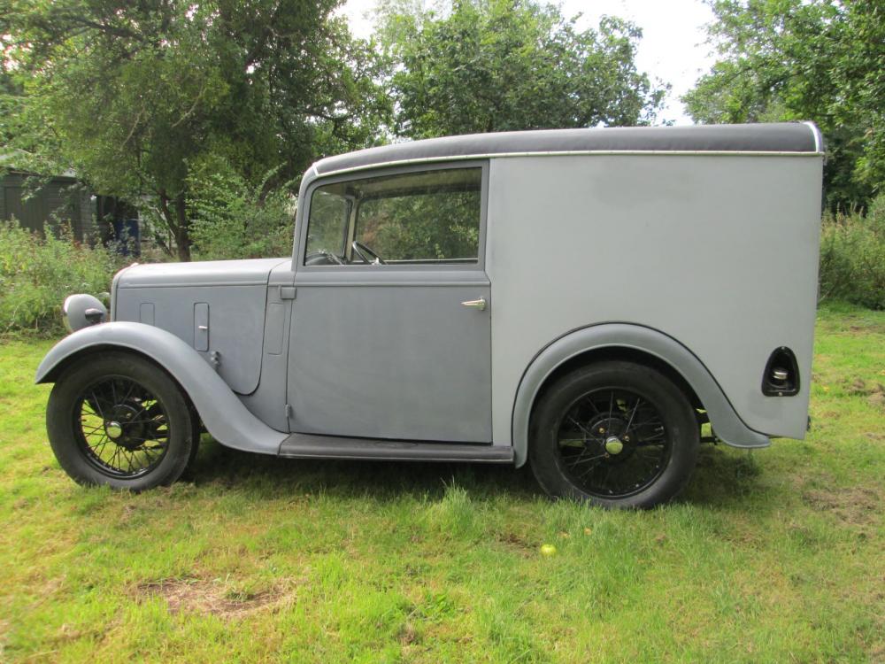

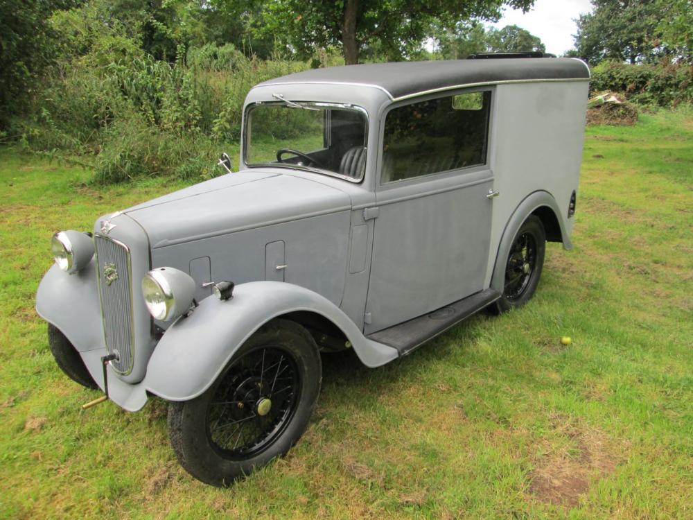

Nearly two years ago, we were commissioned to rebuild a hideous van conversion on a Mk 1 Ruby chassis.
A previous owner had cut off the back end of the saloon body and, seemingly without a lot of thought, had attempted to build an all-steel van body.  Crude, ugly and immensely heavy, an early decision was to scrap it and replace it.
There was, of course, never a Mark 1 Ruby van.  We decided to adapt one of our standard AVK (Mark 2 Ruby) van bodies to fit the ARQ front end.
This job has been something of a pot-boiler, but is now finished - bar painting - and was collected by the customer yesterday.  Satisfaction all round, its seems!

A wonderful job - just wondering why you didn't paint the new van body in a grey colour that matches the front
Thanks, Roger. It's just in primer at the moment; our customer will be doing the paint job. The steel panels are in a standard primer, but most of the new work is panelled in aluminium and so is painted with an etching primer, which is a different shade of grey.

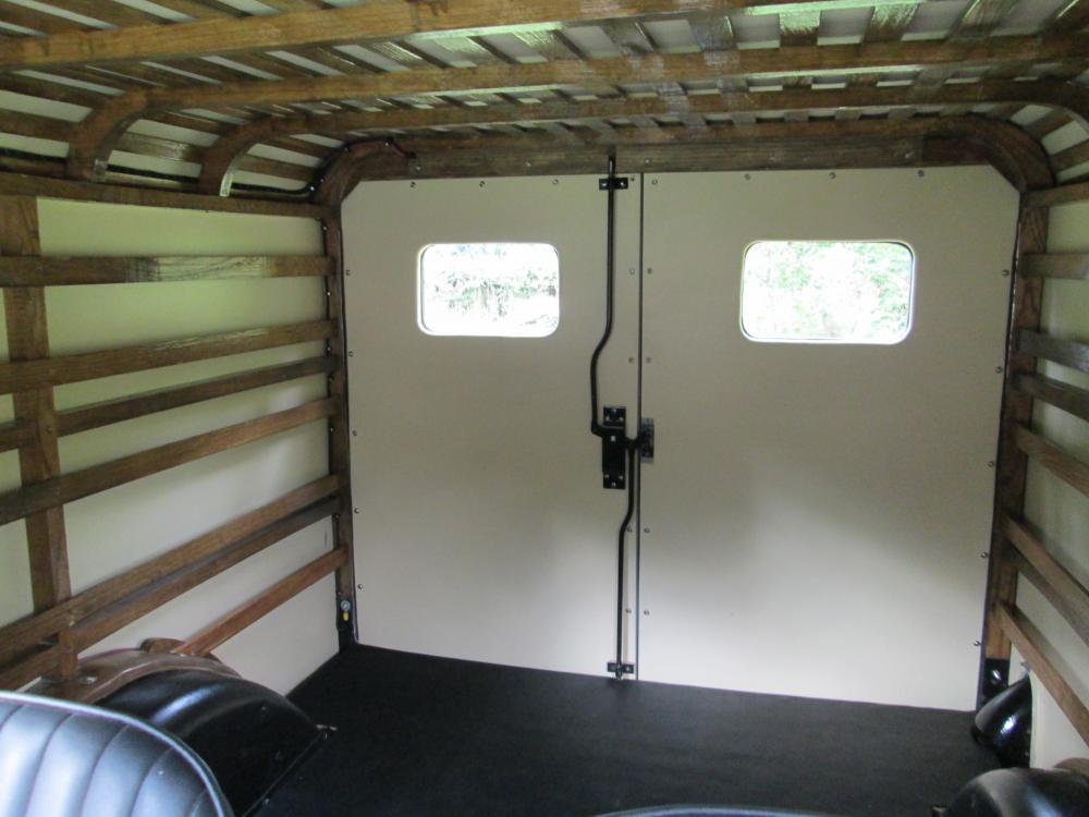

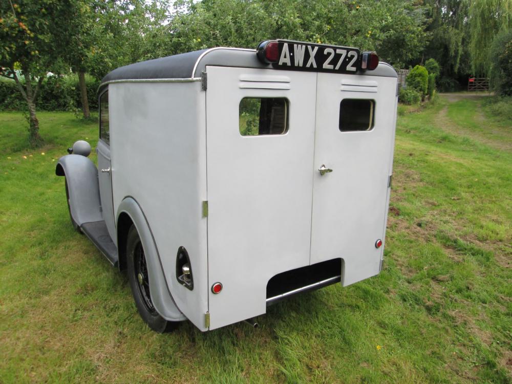

Very impressive, Martin, just one comment: you need to drill 3 large holes in each of the back door linings to provide the ventilation through the louvres!
That looks the business in my book! A lovely job.

Mike - Sssh! I realised as we loaded it into the van that we'd forgotten the ventilation holes!
Oops! Foot in mouth disease. I didn’t make the connection
