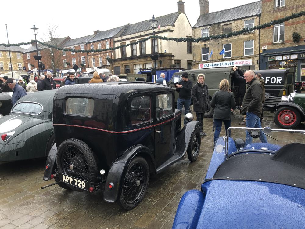

We’ll, it looks like Ruairidh has all the good weather, Rosie and I trundled along to the Brackley Classics Day…a few very unusual cars amidst the cold and the damp…
