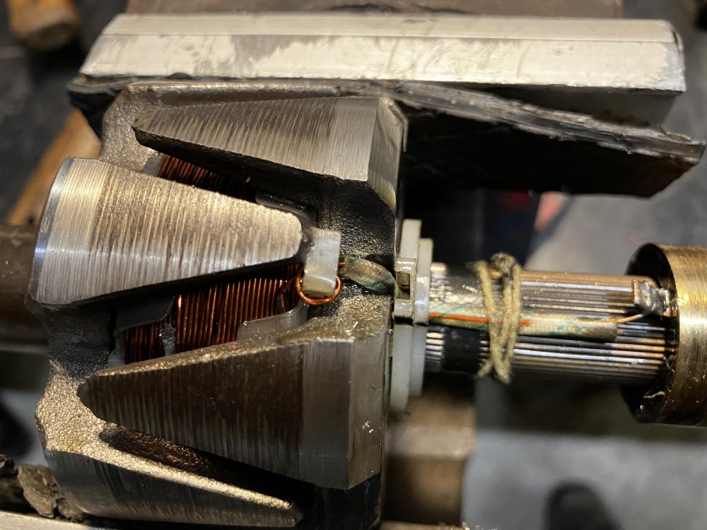

Having tried and failed to get a consistently reliable 12v charging system to work with a two brush C35 and RB106 regulator I have always fancied the idea of a Dynamator. I have managed to do my A7 driving with no charging, setting off and getting all day on the 12v battery charge (e.g. the arduous Beamish Run) without issue, just that red light shining at you unblinkenly. YES; I do know about the Dynamator gear problems with the angst that has caused but that's easily avoided and I don’t recall anyone saying there had been similar widespread bearing or internal electrical problems so it seemed a good technical step forward. Stuart Giles had had a similar go at a defective Dynamator, posted here, with helpful photos (thank you), that had an open circuit rotor. Accuspark don’t make them anymore and after enquiring about them I get the impression after what happened and what was said that they want to distance themselves from the A7 variety. My opportunity came a couple of months back when a ‘spares or repair’ unit came up on that well known on-line auction site. Once secured, I immediately started a strip down to determine what was ailing it, hoping it would be something easily fixed. It was obvious someone had had it in bits before and not found the fault(s).
It comes apart in a similar way to a C35, go in from the distributor end removing the circlip and disc to slacken the drive gear nuts at both ends. Remove the distributor drive worm (not losing the tiny key) by drawing off the end housing. The regulator and brushgear can be removed from the opened end and the internal body terminals similarly from the ugly external block (take a photo of the connections on your phone and make a sketch of the wiring arrangement!). Remove the four body screws and unthread the rotor. Testing at this point revealed that the rotor winding was open circuit (was this the same Dynamator that Stuart had a go at?). Oh poo. The fault wasn’t visible so I was determined to press on and perhaps rewind the rotor. That necessitated removing the bearing and sliprings. A simple puller got both off though the bearing was very tight on the spindle. But despite a valiant attempt I could not get the rotor claws off the spindle, they were V tight. Having the coil now unsoldered from the slipring I noticed that one tail end wobbled about and with a bit of poking about with a pick I found the winding was broken just where it exited the coil towards the sliprings. Eureka!!! Happy days all round! Further probing released the first turn of the winding and I was able to pull it through and re-establish the winding testing out at 4 Ohms so there was fortunately only the one fault. The body coil and rectifier tested out OK with no more open circuits or earth faults. Reassembly is the reverse of the above. You can get the gear end bearing out by removing the three internal screws and sliding everything off the spindle.

(18-03-2023, 07:08 PM)Speedex750 Wrote: Testing at this point revealed that the rotor winding was open circuit (was this the same Dynamator that Stuart had a go at?). Oh poo.
Well done for finding and fixing the faulty rotor. Happy to confirm that all the left over Dynamator bits from the repair that I did are still lingering in my workshop somewhere Smile
It looks like the Dynamator I repaired using the rotor from a donated 'dead' unit has failed again, and I hope to have the unit back here in the workshop over the  next week or two. I will have a look to see if it's the rotor I replaced that has failed or whether it is some other fault this time. The other components are fairly generic so should be fixable if the regulator or such has let out the magic smoke.

Thank you for the responses to my overly long tome. My rotor winding had a break just as it exits the wound coil taking a loop round the nylon guide, fortunately it was the top turn rather than the first and I could unravel enough to remake the tail. It wasn't obvious why it had failed, it didn't look overheated or mechanical damage and I can only imagine the wire had a kink that had been pulled tight, hardening the copper. Surprising on such low mileage (the brushes still had machining marks) as presumably it was made in a production facility that will be turning out thousands of similar windings. I am wary of expecting it to recharge a flat battery, that seems a recipe for a disaster. Replenishing what the starter has taken out (not much with 12v starting!) and balancing the running load will be sufficient for me!
