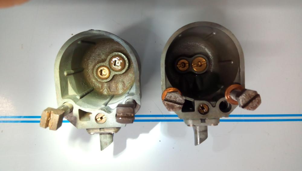

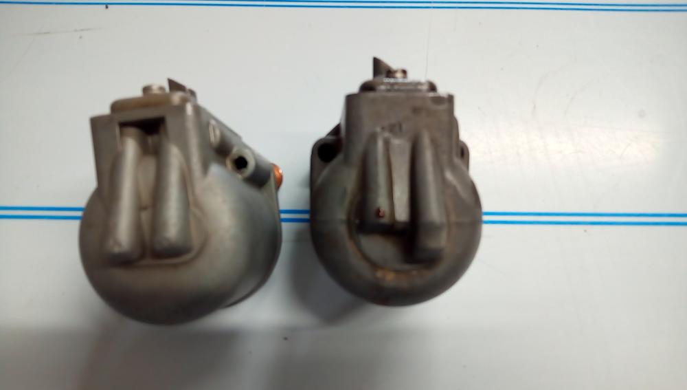

The bowl on the carb on my car is subtly different to that on the spare carb, in that the jets are in slightly different positions and the resulting moulding on the base is different. From what I can tell the rest is identical, the emulsion block and all connections look to be the same. I therefore bolted it on and the car sprung into life and ran as sweet as could be, revved if anything better than it has in a long time. Problem apparently solved.

Andy, I had a very similar situation to you which I posted in this thread: Zenith 26VA differences
In my case, the differences weren't so subtle. One float bowl has a completely flat bottom. Also, as on yours, one set of attaching bolts is hexagonal and the other square.
I was pointed to the answer, quite likely the one you remember, here: Carburettor problems.
However, here's the nub of the matter, the combination that works best for me is a mismatched one! When I attach the bowl that is supposed to fit the idling cannot be lowered to a sensible speed but with the "wrong" bowl it runs sweetly - the exact opposite of expectation.  I have been running that way for a few weeks and all seems well.

Strangely what I have on the car (as purchased 15 years ago) is a mismatch from R's photos. I have a single tube top and 2 uneven length tubes underneath (my picture above right), whereas it seems this top should have a 'bowl' style under the bowl.
The spare carb from Holmesdale is unsurprisingly right in every aspect. It has 2 tubes top and 2 even length tubes under (as per R's picture).
I think I shall bite the bullet and swap the whole thing over. Need to get some high temp silicon sealant first for the banjo.
