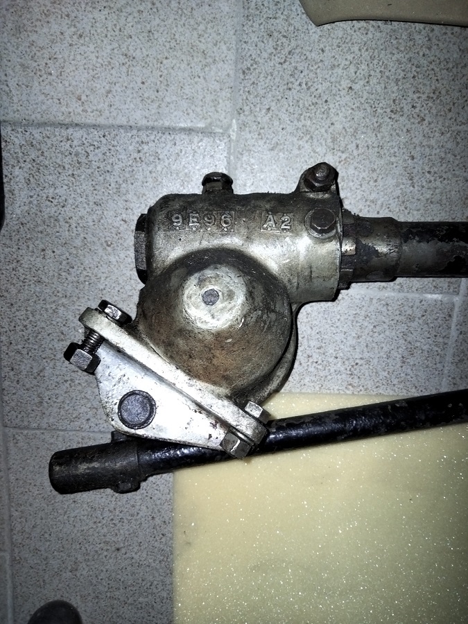

I was a bit concerned about the steering box because I noted that it was too high compared to the pictures of other 65 competition.
I measured tha angle between chassis rails and steering column and found it was incorrect (37° instead 33°1/2... please correct me if I am wrong)
I was afraid that the steering box was not original. Instead I was happy to find a shim under the rear bolt securing the box to the chassis rail and now I suppose the box is correct for a sport chassis. Can you confirm?
[Image: IMG20211025181319.jpg]
#37
its a 9E box casing so its sports... as per the 65.
#38
Yes that is the correct box for your car.
