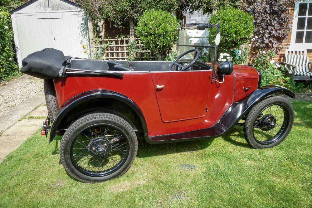

A friend who is starting a wedding photography business has asked to use the Chummy for a staged photo shoot this evening so, much against my principles, I have been doing a bit of cleaning and polishing. Let's hope the bride scrubs up as brightly.

Lets hope the bride is correspondingly dainty! People have evolveded in 90 years.
