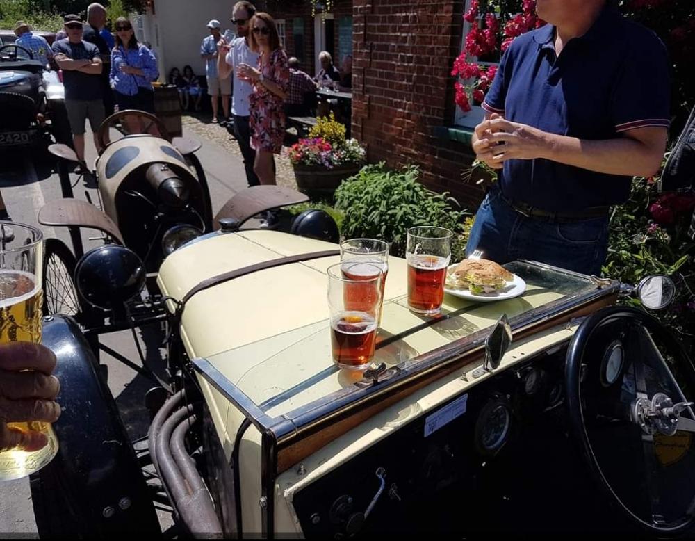

Joined: Aug 2017 Posts: 3,524 Threads: 110
30
FWIW I agree with Tony.
I also wouldn't underestimate the task of matching a wooden plinth neatly to the curvature of your scuttle.
If hell bent on doing it, I can't see why you shouldn't slot the dash upper flange so that it can be pulled past any (loosened) fixings, though I suspect you'd end up removing them anyway. You could weld captive nuts inside said flange then the job of doing up / undoing would be easy.
Wouldn't it be easier still to move them a fraction forward though?
21
nice one charles,
is that a ham salad cob?
tony
