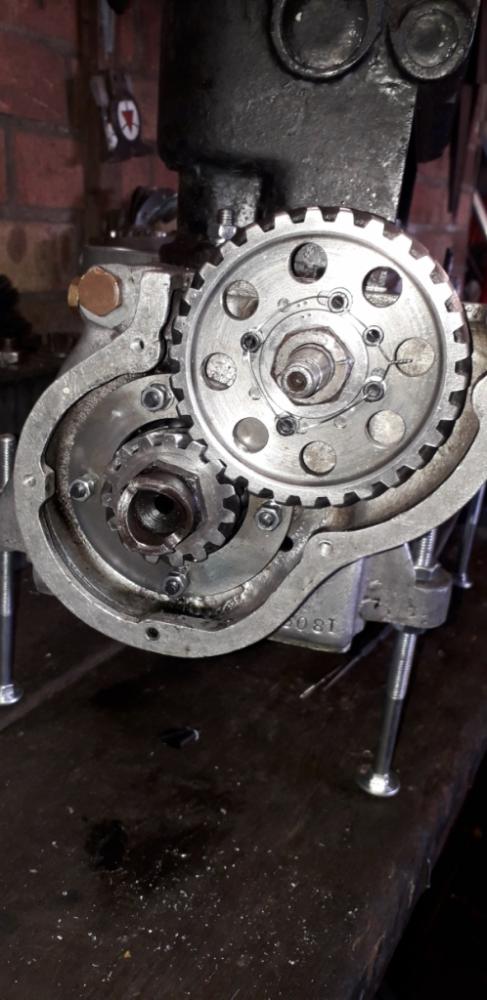

I'd personally use an adjustable (aka "vernier") cam gear. It's not a massive mod.

If the maximum lift figure is 'off' when you install any new cam, it's almost certainly going to be because the keyway isn't accurately placed in your timing gears. The cam grinder references all the lobes from the camshaft keyway. Although I've had to make an offset key for a number of motors to get the timing right when testing the usual number one inlet, all the other lobes have been spot on once the right key is in place.
@Charles P did you turn up a steel hub for the timing wheel to create the adjustable gear using a re-machined factory outer?

New EN24 hub and the outer of an existing steel one. I hate machining short tapers and made a dummy centre to prove the taper was correct. The construction uses slotted holes in the "outer" part and button head cap screws. As a failsafe once timed I removed one cap screw and filed a pair of "lozenges" to fit into the residual oval slots to avoid the potential for movement. They are retained by the washer under the cap screw.

Thanks all, I have a stepped key on my current gear which allows for adjustment by half tooth. Depending on how it fitted I might have to try something more sophisticated, in which case I'll get in touch with Dave. Does he need the original outer part of the gear to start with?
