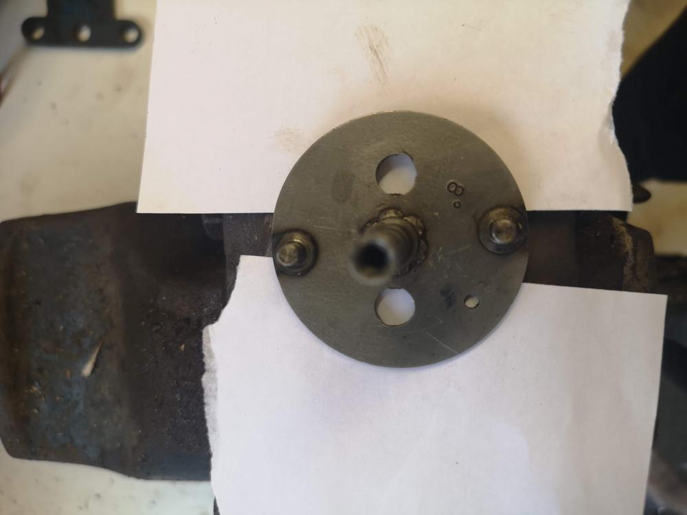

I am overhauling a DK4 automatic advance distributor. It seems to be in fair condition, apart from a cracked cap and worn serviceable parts. It has an 8 degree advance plate, but I understand that the version fitted to the higher compression engines has a 12 degree advance. As my engine has the later higher compression Ruby head, I assume that 12 degrees is more appropriate. Does anyone know how I can modify the base plate to give the extra advance? I assume that the holes need to be enlarged, but does anyone know by how much?

Most of the ones I've seen have considerable wear to the holes that limit advance. They probably advance more than the number stamped on the plate.

post a pic of your holes?

My own experience of modifying the advance plate is that you will do better to proceed slowly/ incrementally and measure the result (use a DTI). It's not quite as 'linear' as one might suppose. As Austin says, many plates need reducing rather than increasing, once stripped the hole is 'restored' with a blob of weld and filed back to the desired size (flattening off the blob, of course).

I had problems with the timing over-advancing on my 37 Ruby; when set to give a reasonable pick-up at low revs it sounded quite rough at higher revs. I took the distributor off, clamped it in the vice and made up a couple of plasticard discs, one to screw to the distributor body, and another to slip tightly over the shaft where the rotor arm normally fits. Having marked one of these in degrees I was able to accurately measure what was happening. I found it to be advancing by about 12 to 13 degrees even though the holes looked only slightly worn.
I welded up the holes in the base plate as Chris described, then gradually opened them up with a round file until I had my preferred 7 degrees. You can do them one weight at a time to make sure they both "stop" at the same advance.
It made a big difference to the running of the car. Well worth the time spent.
