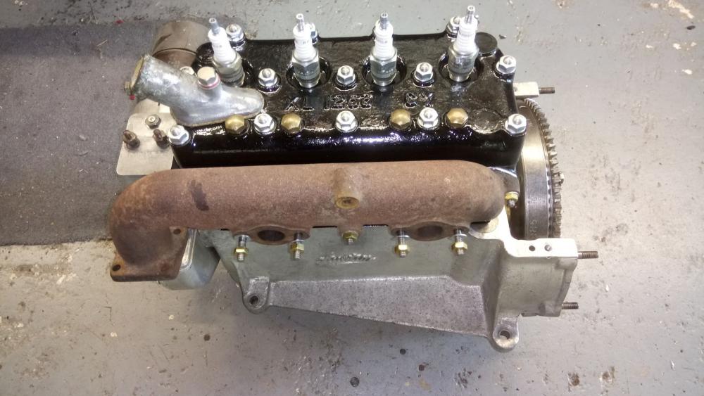

Engine is finished!

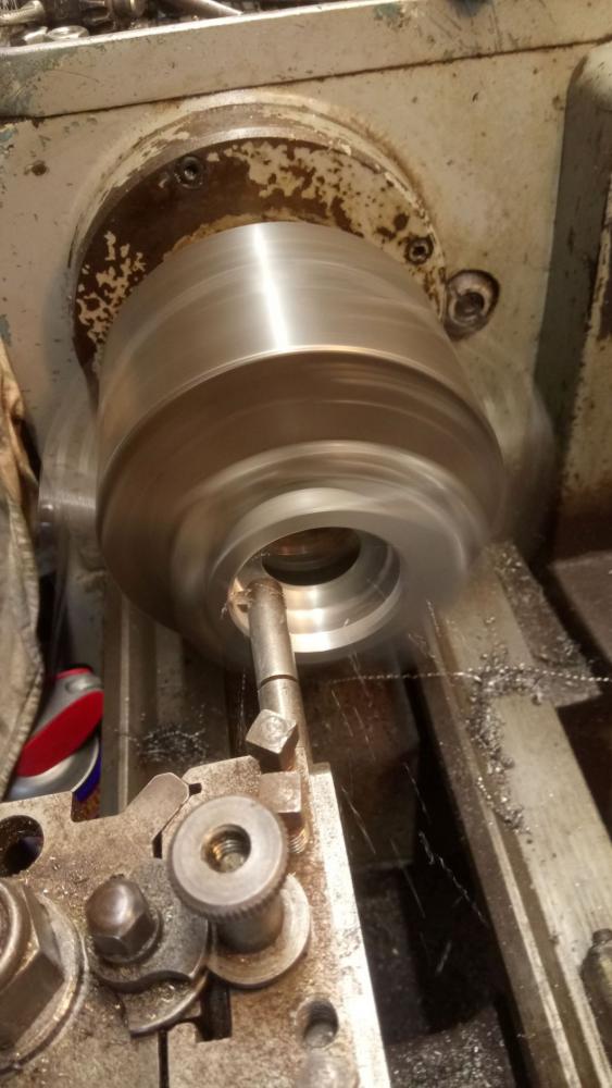

Final job was to machine the front crankshaft oil seal housing to accept a modern oil seal. The housing is 1 15/16" in diameter but the oil seals available are either slightly too small or a full 2" O/D.
I went for the larger size and a 5 min machining job:
Final fitment:
And the completed engine:
