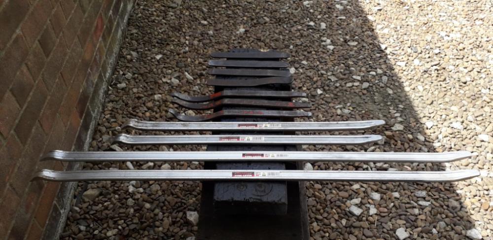

I would choose the shortest of the bright silver levers in Steve' photo. Use them to remove tyres. Don't use levers at all to fit tyres.
Some years ago, I bought a pair of 'Heyco' brand levers, very similar to the silver ones in Steve's photo. They are 16" in length. Frankly, they were a revelation after struggling with all sorts of rubbish over the years...
Mine are Melco, acquired from Halfords a good few years ago - about the same length as Hugh's I guess and adequately strong (it's not difficult to bend them if 're-purposed' for other tasks, though more than strong enough for tyres!)
Use the shortest that you can, otherwise excessive strain can be put onto and into the tyre carcass. Damage to the shoulder can cause chaffing to the innertube in service. Use tyre soap or washing up liquid (don't get caught in the kitchen) and I have some short, 4" , sections of garden hose , split lenghtwise to slip over the rim where the tyre levers are pivoting to protect the finish.
Would suggest not washing up liquid. It contains high concentrations of salt and rots the wheel rim. If proper tyre soap isn't available, Waxoyl does the job and has the advantage of adding some protection to the wheel rim. Of course, if fitting tyres for trials that will be glued to the rims once fitted, any form of lubricant rather defeats the object of the exercise!
The two pairs of long levers in my photo are 36" and 24". Never used the 36" ones but the 24" have come in handy removing a very old and very hard pair of tyres from good wheels. My favourites are the three levers in the middle bought years ago from a French Supermarket. The curve in them gives a little extra leverage when needed and the slight hooks at the tips locate under the tyre bead well. The short levers are all marked 'Dunlop' and inherited from my Father. Probably made pre-war.
