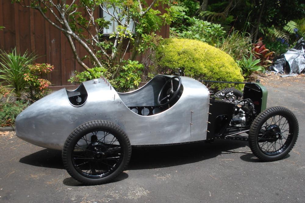

I have almost finished fitting the skin, all rivet holes are drilled and it is currently secured with Cleco skin pegs, starting to think I should call it the porcupine! Next job is to make the windscreen and ensure i don't need any more bracketry inside the scuttle, once that is done I can rivet the skin permanently in place, make the sills, valances and bonnet sides.
It's all looking rather good. Very impressive indeed.
At the risk of "granny and egg-sucking", don't forget the zinc chromate paste on your rivets...
I am not familiar with the use of zinc chromate paste ,but I assume it’s to stop corrosion in the rivet
Yes, it's designed to prevent galvanic action between aluminium and steel.
Looking great Ian. I should mention Ian's paintwork is exceptional. I know a lot of effort went into getting the right level of gloss or flatting on the different parts and it really helps make the car look exceptional. It's another of those little details that gives a more professional finish to things.
