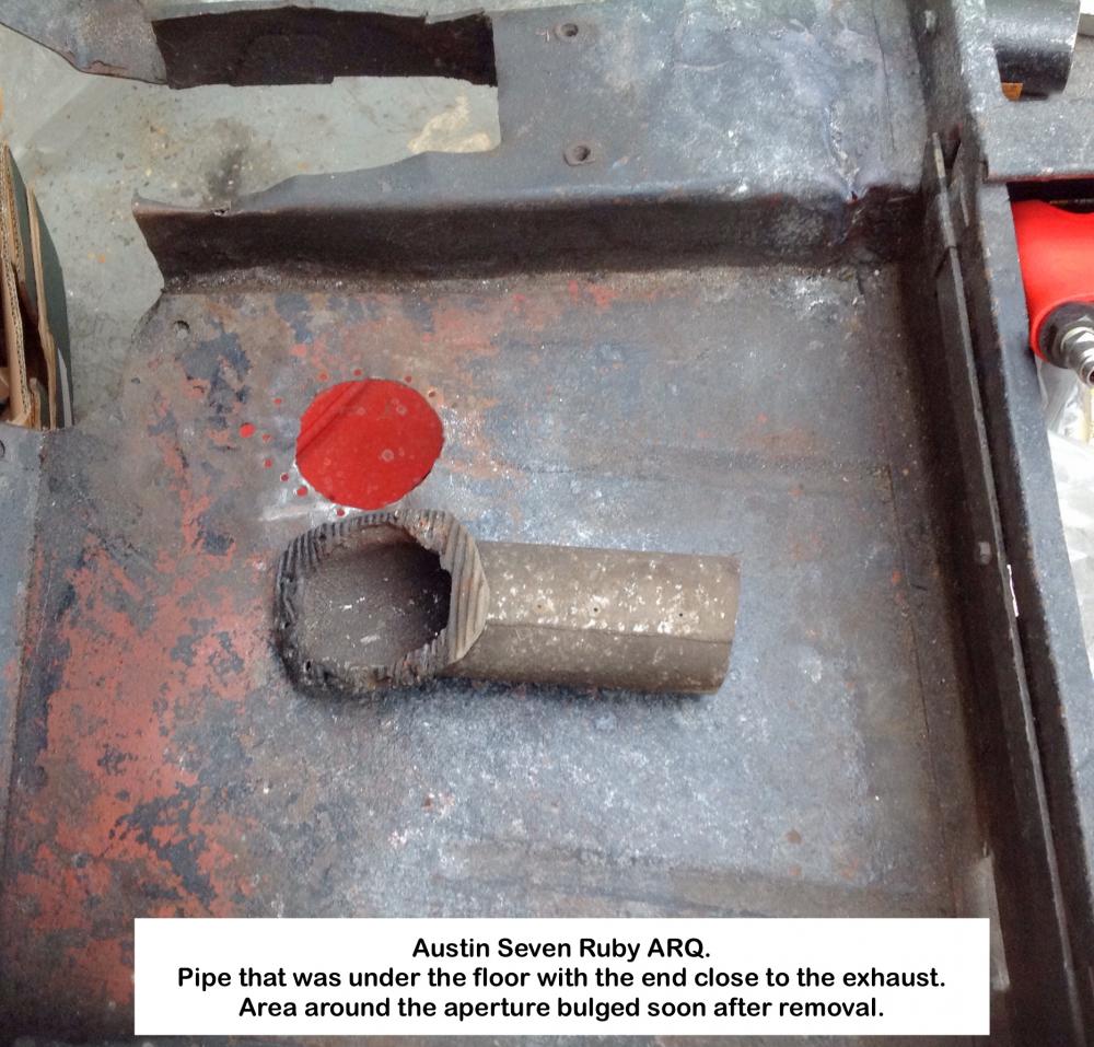

Looks a bit as if something has been dropped on it.

I wonder if those extra brackets and steel bars attached to the front of the seat base were some sort of strengthening for hauling heavy loads and subsequently the cause of damage to the trans tunnel?
#53
The bars are for securing and adjusting the seat runners that pass through the seat box. Thats quite a ding on what would be a reasonably strong corner. I half wonder if she was tied down onto a trailer with a chain ratchet through the doors. My brother had two weird dents in the roof of his minor that we later found out came from hooks on a two legged chain. That car must have been a cat, as it was very close to being scrapped...

No evidence of shunt damage or repairs on the body
The vertical face are the bases the seats afix to.
Chassis is in perfect condition apart from rust pits that where hidden under the felt strips and a warning to others who still have them on their cars.
That pinch may have appeared after I removed the pipe shown in the photo, with the area around the hole bulging slightly.
That pipe faced toward the rear with the end close to and pointing towards the exhaust.
Wonder if having the car on the rotisserie has anything to do with it?

The car arrived without any securing method that would have caused any damage.
Oh, just remembered‼️
The body was, however, outside and raised off of the ground on two lengths of scaffolding planks, placed crosswise, and resting on axle stands and during a period of fierce winds the car was lifted clear of the planks and stands and the NS rear corner/Mud Shield landing on the concrete paving.
The is no evidence of any damage to that corner but who knows where the force of hitting the concrete, if any, went.
Have posed a question to Simon about the rotisserie, but the car rotates with ease.
Geoff - A mystery to say the least, and bugging me no end.

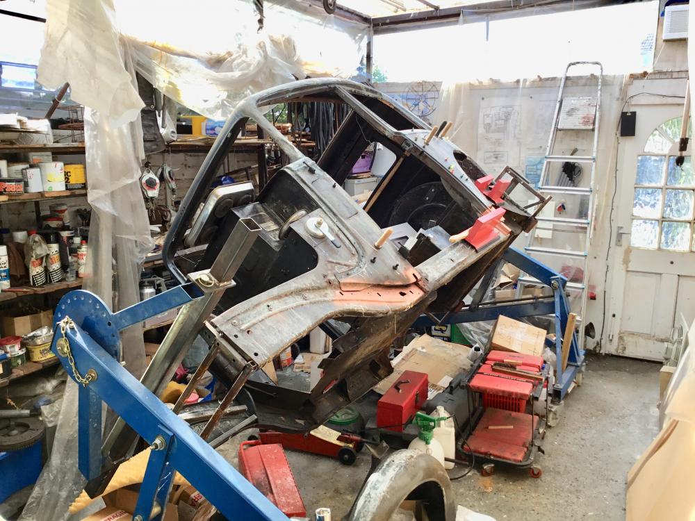

Before my Thread disappears into the distance, latest photo.
Had tilted the car to where it was comfortable to work on the NS Flitch plate, then some 10 minutes later found myself in an Ambulance with Blues & Twos going full bore.
