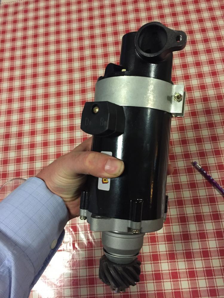

Hang fire on going to 12v just yet Stuart.
This is ‘the’ 6v prototype of the same make.
If it fits and works they will put it into production very quickly.
I personally think this product will have more draw than the 12v unit originally produced.

Hey Stuart - I think if we can have a 6 volt alternator that would be the best way.
Much cooler than going onto 12 volt.
Cannot understand why the 6volt one was not developed first.
Hope we can eventually get a 6 volt unit for the early cars.
Great lighting ect without sacrificing the vintage benefits of 6 volt as fitted to the car.
Will make it a very easy "no brainer" for the mass of us who are on 6 volt
All sounds very exciting.
