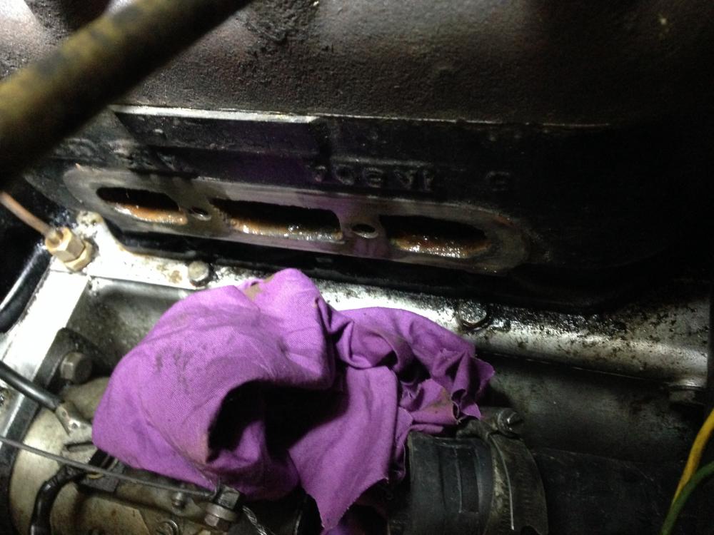

As the man who merely came second in class 3 at the Silverstone Autotests, my congratulations once more to the winner, Scott, who would look handsome on the podium, if there was one. The water leak was investigated, and the process perhaps inevitably resulted in both studs smoothly coming out of the block.  Before cleaning everything up and putting them back in with locktite, I looked up the forum, finding much discussion of the desirability or otherwise of stainless bolts etc. However the car had to be mobile the next day so reassembly took place. The Ruby was needed for a nav rally recce, we care not about subjecting entrants to single or even double chevron ascents, occasional engagement of first is part of the fun. However downhills are seriously considered, and the route changed if sufficiently steep to cause abject terror for the navigator.

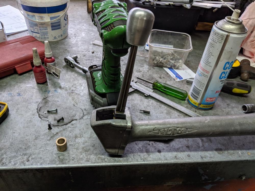

Thought I would take the special to lunch as the weather is perfect at the moment but only made it to the end of the road when the gear stick went all floppy and I only had 3rd or 4th so a U turn and went in the modern instead.  The back bush on the Eltos had worked loose so decided to make a nylon bush to replace it, mainly to make it quieter, a big disadvantage with these remote gear linkages is that they transfer the noise from the gearbox to a place much closer to your ear.
