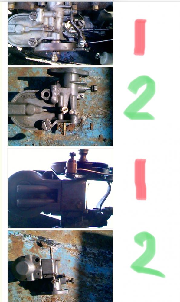

As requested by Ruairidh, I post photos as follows:
1. Top of the carb (my spare body) numbered 26VA C (or 0) 548
2. Top of the old body (the one that was giving me problems) numbered 26VA R1634
3. Bottom of the float bowl I am using that was originally fitted to R1634 and is now on C (or 0) 548
4. Bottom of my spare bowl (which when fitted to C (or 0) 548 hunted badly and was quickly replaced by my original bowl.
5. Generic shot of 'bitsa' carb in place.
Any ideas as to what is wrong with the R1634 carb body would be most appreciated.

Sounds like you have sorted your problem but I have labelled the photo below to show the ‘correct’ combinations of parts -
1 and 1 go together.
2 and 2 go together.
Do you have them like that?
Ruairidh,
Thank you for labeling the pictures. In answer to your question, they are now.
When I took the carb off, top 2 had float chamber 1 fitted. This was the carb that gave me a wild tickover. Top 1 and float chamber 2 were out of the bits box and so far as I am aware, were never actually fitted together.
Would having the wrong float chamber have given me the problem? That combination ran fine otherwise.
Body 1 and float chamber 1 are now together, as can be seen from the photos.
I hvae just got back from Blaenau Ffestiniog ( approx 50 miles return) and the car has run like a watch!
David,
They are commonly mismatched and, when so, give the symptoms you experienced - hence my request for photos.
Glad you have it sorted.
Are the two bodies both '7' matched ones, Ruairidh, that just don't behave well when mixed, or is one of these of Davids an '8' carb with larger choke?
As above Jon.
I don’t know the answer to your second question.

Ruairidh, What is the difference between the two float bowls as shown in the photos (Red1 & Green2) and which one is the correct one for a '35 Ruby. and why would it make such a difference in idling revs?
Post a photo of your carb and I will tell you which bowl matches it.
There are several differences in the bowls and although they work if mixed tickover is much improved if you have a correct pair.
The carb with two tubes here...
.jpeg   3AD74CCF-5994-47D3-8408-FBAF905A1B41.jpeg (Size: 505.22 KB / Downloads: 559)
Matches with the bowl that has two tubes underneath...
The carb with one tube here...
Matches with the flat bottom bowl.
.jpeg   F9CEDC98-4A47-41FD-B93B-67EC595B4FBE.jpeg (Size: 399.83 KB / Downloads: 563)
