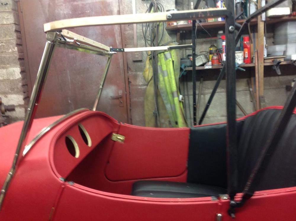

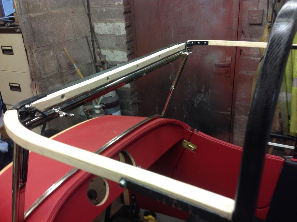

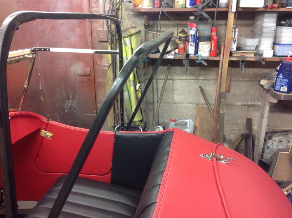

Hood frame adapted slightly to make the peak a little heavier for weather flap etc...
(01-01-2019, 08:35 PM)Ruairidh Dunford Wrote: Hood frame adapted slightly to make the peak a little heavier for weather flap etc...
Well done R - that looks nice.

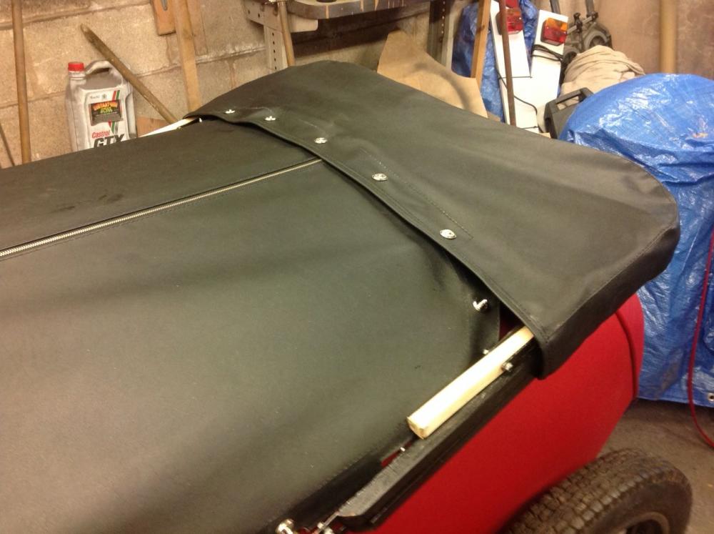

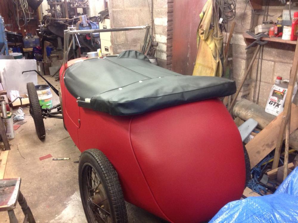

Tonneau and hood bag now complete - some issues with the hood are still to be resolved...

(16-02-2019, 12:25 PM)AllAlloyCup Wrote: Have you opted for an Everflex material for the tonneau, hood bag, sidescreens and hood?
No, this is exterior quality vinyl leathercloth - for the reasons above.
(16-02-2019, 12:25 PM)AllAlloyCup Wrote: I managed to get some stainless lift a dots from the USA as I’ve found with other types that they go rusty.
I’m interested to know if you’ve used double height lift a dot pegs on the rear cockpit?
I have had no problems like you describe with Lift The Dot fixings, all my cars are fitted with them.
The pegs are indeed double height.
(16-02-2019, 12:25 PM)AllAlloyCup Wrote: I was going to use single ones as I was thinking, either the hood is on, or the tonneau is on, or the hood bag is on.
This is why I asked him to use them.
