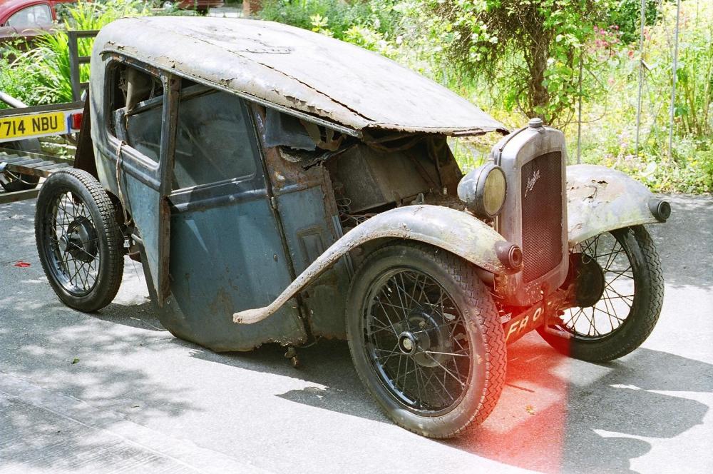

    Here's another view of it, this is what is known as a long term project.
