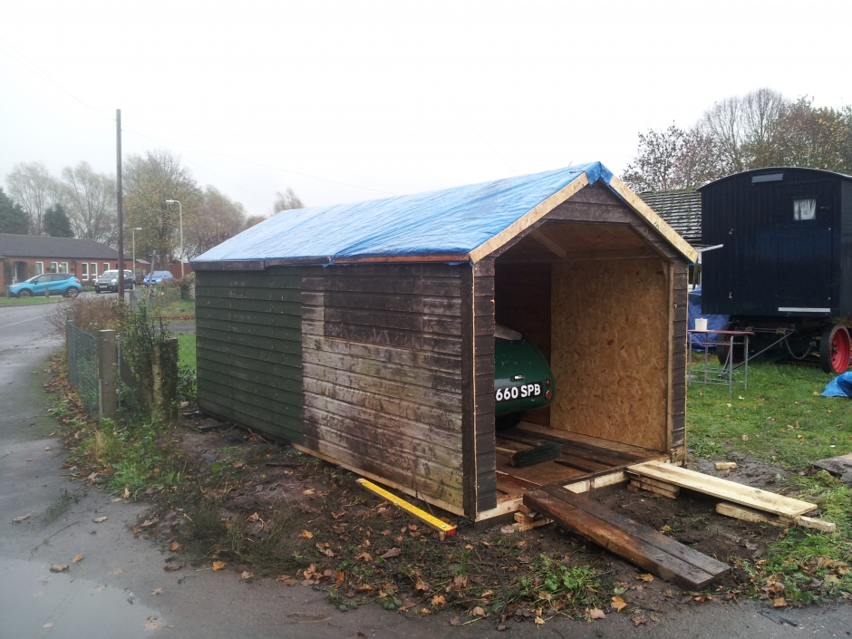

Here we go, shows how simple it can be.
There was a large hedge in this location. Father and I spent a day pulling it out, and burning it with the traction engine. So the space for the shed was free.
Foundations are some hefty fence posts laid on the ground (level). These were coated in numerous coats of engine oil as preservative.
There is usually a family of hedgehogs in residence in the void underneath.
With the doors shut, it looks like a shed at a glance, rather than a garage (even with the large doors)
Part constructed

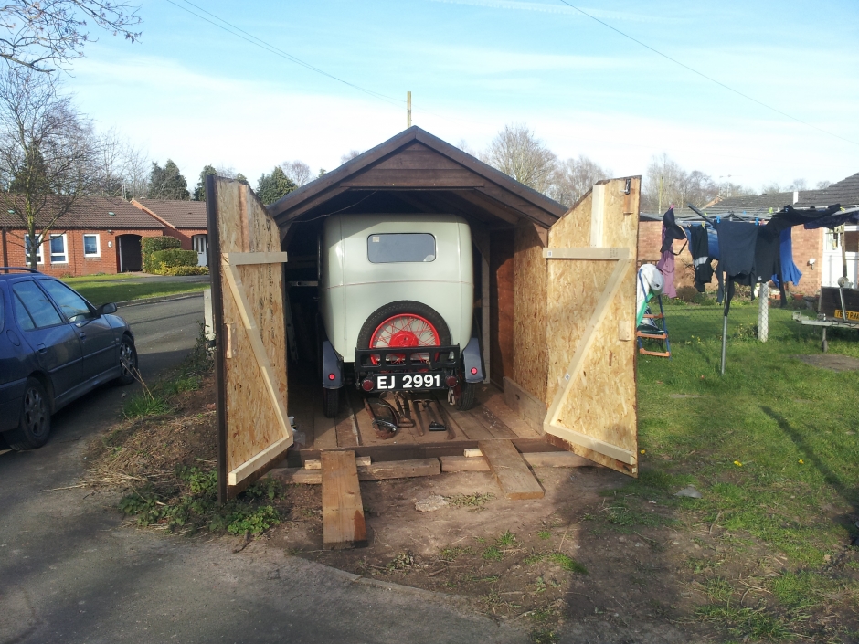

The entry ramps are now better engineered, but essentially finished

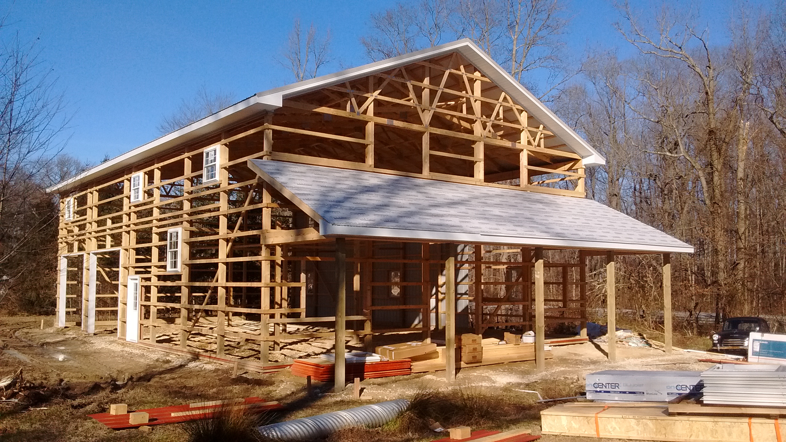

Speaking of sheds, this is what is going in at my house right now
[Image: IMG_20190131_143524018.jpg]
I have numerous dependent vehicles that need a roof over their heads. Mike
Located in very chilly Maryland
Four Candles! Now that's what you call a shed! Cool.
If you can arrange it, a hefty beam is very handy to hang a chain block off to lift up engine/gearboxes and so on.
Mike's shed is bigger than my entire house and garage!
