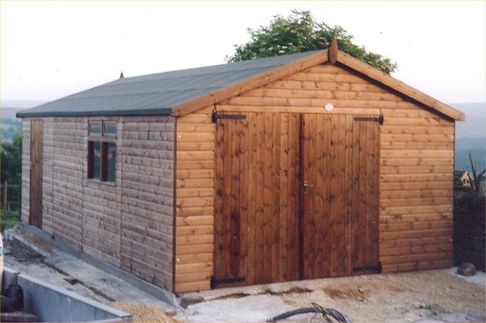

We manufacture timber buildings of all types, including garages, to order - they don't need to be as fancy as "The Motor Works"!
Timber garages are much drier that concrete or brick.  I've kept my cars in our own products for the last 44 years and have never had any issues with rust or rot.  We can, of course, supply them insulated and internally lined and also with wooden floors that are robust enough to take the weight of cars much bigger than an A7.
Please PM me for more information.
.jpg   GAR-Cargill1.jpg (Size: 3.55 KB / Downloads: 447)
