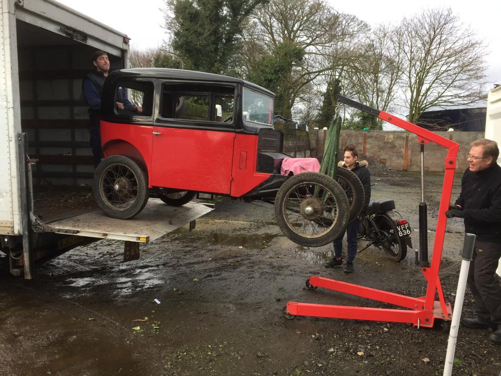

Sorry I haven’t been around for a while, after what seems a lifetime running my own business, I’ve retired at last closed down the business and returned to the Isle of Wight.
Health and safety officers can look away now!
I booked a van with a tail lift to pick up my Austin and other workshop equipment, lathe etc and with the ferry booked, the van turned up and it was a high bodied Luton...with no chance of changing the van, we had to get creative in order to load it...anyway it’s home now and I’ve already started to put it back together!
(28-01-2019, 05:23 PM)Ivor Hawkins Wrote: Sorry I haven’t been around for a while, after what seems a lifetime running my own business, I’ve retired at last closed down the business and returned to the Isle of Wight.
I'm not even going to ask how you got the back end on...
With the tail lift on the floor I guess.
