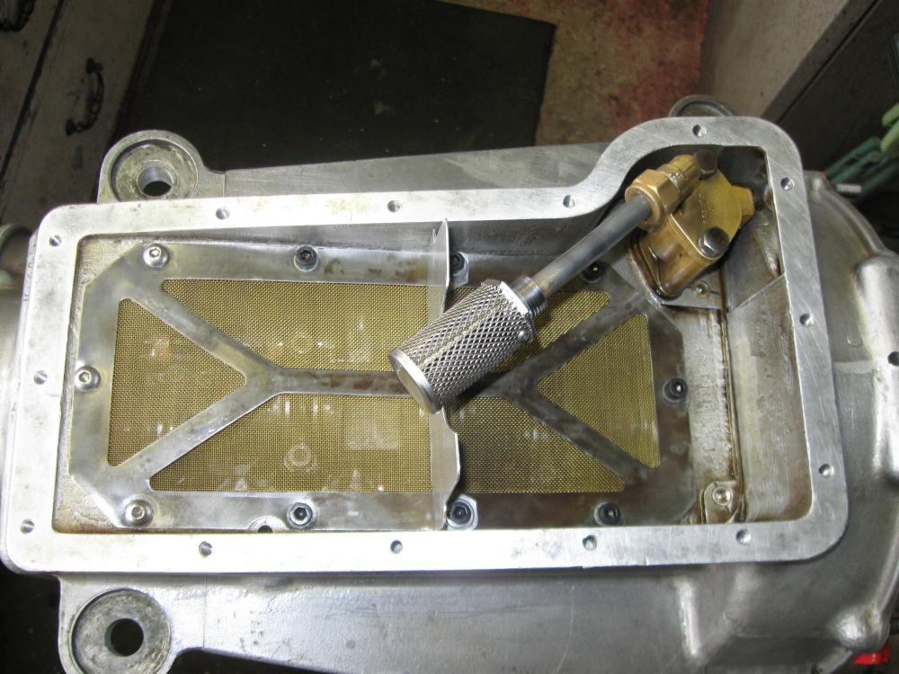

Confirmation of screw thread please?
 - the two slotted grub screws which blank off the two oilway drillings, next to the oil pump and one on opposite side which rises towards the oil pressure gauge connector - 1/8" BSP (parallel)?
And do we know anyone who stocks these grub screws?
(n.b. 3 bearing engine)

Hi,
I think you'll find they're 1/8BSP TAPER i.e. - 1/8BSPT. The thread is tapered so it tightens and seals as it goes in. Brass Allen heads make good replacements; available from that well known on line auction site. The originals can be a sod to get out; heat up and use an impact driver.

Amen to that! But now removed thanks.
Yes, I asked about source because there is a certain amount of vagueness about thread form on eBay. BSP sometimes turns out to be NPT for example, which is nearly but not quite. Will have a good look tomorrow.
