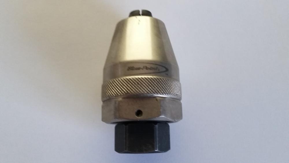

I need to remove and then replace all the studs on my block. Years ago I used mole grips or small Stillsons for this task, but have decided to do the job right and buy the proper tool. I can see Austin Seven ownership involving quite a bit of stud work over time.
Please may I have your recommendations about the best tools please?

I've just bought the Sykes Pickavant set of metric gripper/remover things which were about 24 quid on ebay in the sale. They are mentioned in another recent thread which is why I thought they were worth trying (plus diesel and acetone).

That’s what I have too. Usually works. If it doesn’t what I normally do is cut the stud down and weld a 3/8 nut over the end. The heat must free things, it’s never failed yet.

I've had a Sykes Picavant imperial set for years but they don't seem to be available any longer. Given that I've used them on metric studs sometimes, I imagine the metric version will work fine on imperial. What does help, if you've got the facility, is to heat the base of the stud with a gas torch immediately before removing it. However corroded, that usually means I can get all the studs out without breaking any.
