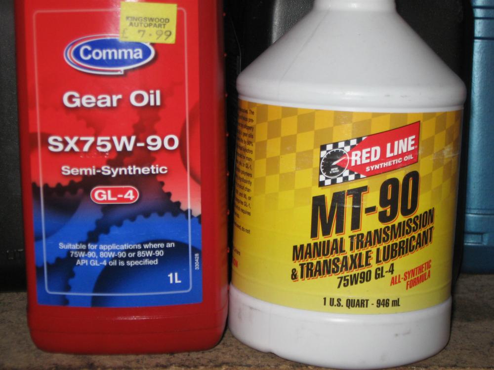

Simon the oil we use for any A7 g/box (see photo)
Gear oil is for gears engine oil for engines the semi syn oil we have used for years in 3 and 4spd g/boxes one pint/half ltr is all you need in a 4spd
  the fully syn oil we use for racing as the box gets extremely hot.
Terry.
I think 1 1/2 pints is far too much for the 4 speed box. It should be filled to the bottom of the filler plug threads and no more. Racing needs are another thing.

I am going to use Penrite Classis Light 20W-60 in the engine. Is that OK for the gearbox too? It does say to replace SAE30 where originally specced. I prefer using the same oil in both if I can.
