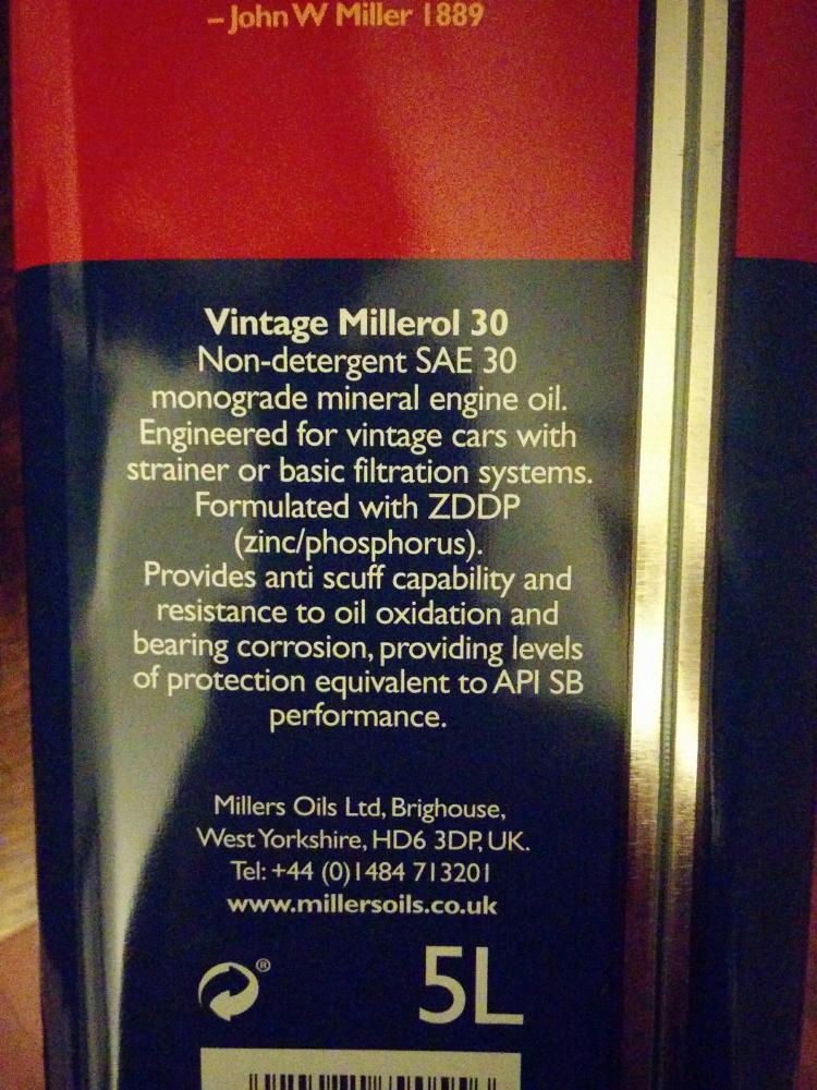

Hi Dennis,
I have a feeling that oil is another "religious" topic in A7 circles! I just do what Nick T tells me and use Millers' Vintage Millerol 30 and intend changing it at least annually. The logic of using a non detergent oil seems to be to allow specs of carbon or other detritus that is not caught by the gauze to fall out of suspension and lurk in the gunk at the bottom of the sump until this is cleaned out, which I intend doing every other oil change.
I have bought the oft recommended "Which Oil" by chemical engineer Richard Michell to try to understand the subject better. Once I've read it I may be able to argue with you!
The attached photo of the side of the tin seems to describe the Seven engine pretty well. The brand also has the inestimable advantage of coming from Yorkshire.

Hi Colin
All understood.  Yes much difference of opinions often expressed......sadly sometimes from old fashioned ideas that "that is what was recommended by the car manufacturer" without thought that oil has come on a long way since those days.  I too have done much research into the uses and qualities of the various types of oils and am sure you will probably have just as sore a head as I did at the end! But much enlightened.
I was referring to an additive that I use which does not alter the oil one uses but merely uses it to get carried around the engine/gearbox etc.  I have the lab test report on this additive from SINTEF (google it and you will see they are a very large and important oil industry laboratory) showing it does what the additive claims as does figures from MIRA tests.  In spite of these two august bodies findings the additive has been referred to by some as "magic of the wizard Merlin type".
I did actually venture across the border down to the former abode of M in Cornwall but unfortunately he was not at home so could not throw any enlightenment on why some thought it magic.  Big Grin
A filter really is a good idea as an addition.
Dennis (in Devon)
#58
Mention of oil steers this off on a tangent well thrashed before. API SB covered oils from 1930s to the cheapest in 1950s and beyond, when cars were often rebored at 40,000. (Perhaps the oil incorporates modern features but is insufficently detergent to qualify as SC or later)
The VW Beetle ran with harder than wm shells and no filter to the end.
In an era when it is difficult to find written materiol pitched at everyday level, and the Internet is a morass, Which Oil is about the best read available. But the writer is not a current oil development engineer/scientist. The vital topic of instant viscosity whilst under pressure and sheer is not even mentioned. Oil change periods adopted are ridiculously conservative.
Back on topic, I presume the shells sold for the 3 brg engines and Big Seven are forgiving white metal. But what are used for the replacement rods?  When cr rose above about 7:1 in the 1950s wm proved inadequate in many engines (notably BMC 803cc)
