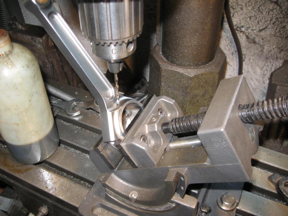

have you done this modification to Pheonix rods yourself and, if so, how and what exactly did you do please?

Tony, I am confused by your answer, drill them for splash fed? Where, and why?
Usual to drill no 4 rod on pressure fed.

Hi R,
Never had to do it, I'm like you. I'd use 1 5/16 with GOOD GOOD GOOD austin rods. I think even if I wanted to go racing, INITIALLY I'd go the same way.

Thank you Tony.
Drilling rods.
                     Terry.
