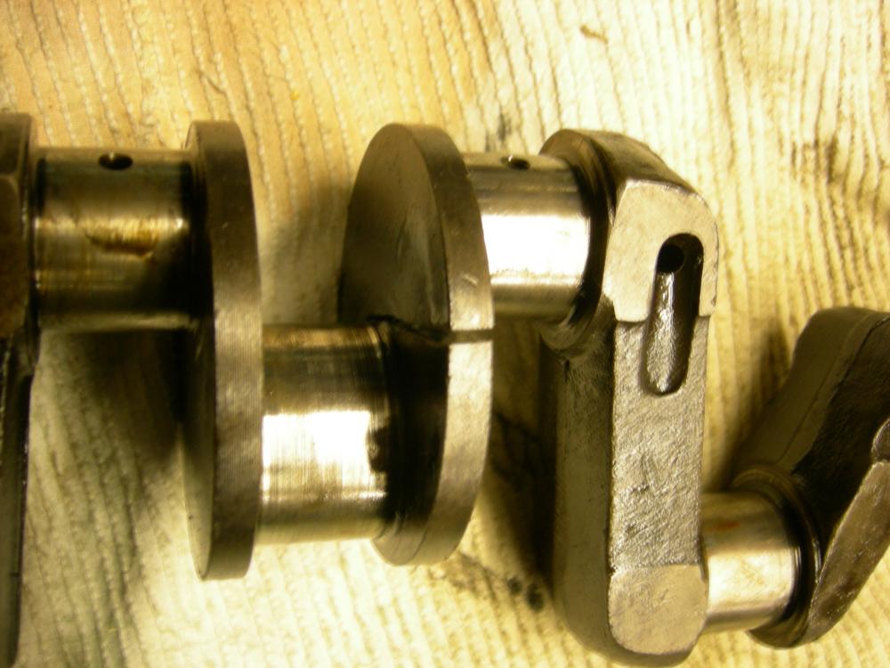

(12-11-2018, 09:13 AM)fatcatvera Wrote: Here are some shots of the cracked crank. The crack hasn't propagated all the way across the web.
Caught that just in time! Bit of gorilla glue and you're sorted!
(that was a joke, just in case...)

And here's mine after a failure year a year or so ago. At least when the three-bearing cranks start to go, they usually give notice of their intentions and provided you stop quickly enough the crank-case usually survives.
Alastair
#47
RAt least the failures are consistent - exactly the same failure as mine.
What did you do to repair Alastair?
#48
'What did you do to repair Alastair? '
I think I personally am beyond repair Confused but as for the crank, it was a case of sourcing another one and crack detecting it before and after it went for regrinding..  I don't know how successful it has been because the rebuilt engine is now sitting in the chassis of my AVK van project, which has traveled less than two feet in the last year!
Good luck with yours
Alastair
