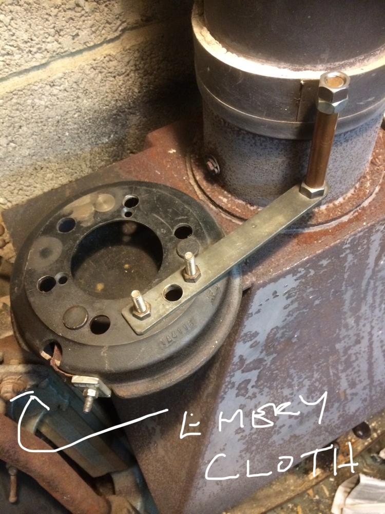

Joined: Aug 2017 Posts: 532 Threads: 46
5
Location: Oakley, Hants, UK
Car type: 1929 AD Tourer, 1930 Rosengart LR2, Rosengart LR4 Van 1938 APE Tourer (Opal)
I made this gadget to take off the high spots on new shoes, it works well.

(09-11-2018, 07:52 AM)Derek Sheldon Wrote: I made this gadget to take off the high spots on new shoes, it works well.
Neat gadget, Derek.
I have to admit that I'm struggling to see how a high spot would only bind in one place unless there was a degree of ovality in the drum. I'll have to give it some more thought.
Again, thank you both for your help

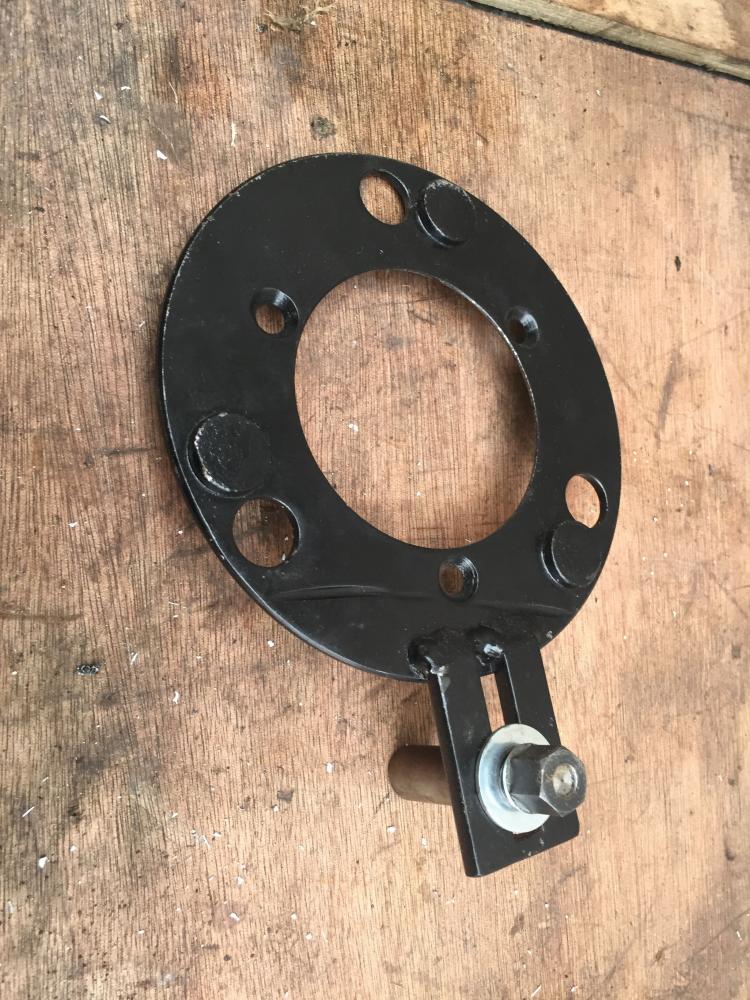

Joined: Mar 2015 Posts: 5,535 Threads: 232
70
Location: Scotchland
09-11-2018, 10:32 AM
(This post was last modified: 09-11-2018, 10:33 AM by Ruairidh Dunford.)
I use this tool to ensure that the shoes are sitting straight and that the surface is level.
Works extremely well.
Joined: Jun 2018 Posts: 560 Threads: 100
2
Ruaridh,
"I use this tool to ensure that the shoes are sitting straight and that the surface is level."
At the risk of showing my ignorance, how does this work?
Regards,
Jamie.
Joined: Aug 2017 Posts: 66 Threads: 17
0
(09-11-2018, 10:32 AM)Ruairidh Dunford Wrote: I use this tool to ensure that the shoes are sitting straight and that the surface is level.
Is that a roller, Ruairidh, or a piece of bar?
