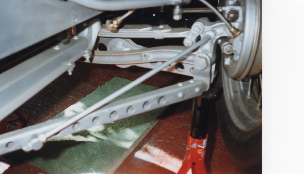

Matt photo of dropped axle (done by Ian Dunford at the time) and home made drop plates it also has a brake tie rod as hydraulic brake are fitted, there is a wedge on top the spring as the chassis had very little castor built in. The radius arm ball joint is dropped to match the 6 degrees of castor.    Terry.

Fantastic looking car Terry ... any build tread or info online ?

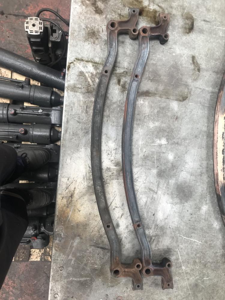

(24-09-2019, 07:17 PM)Steve Jones Wrote: And Ruairidh does a very good job as the one I have here that he did confirms.
Thank you Steve, here are some examples for those interested:
Am I right in thinking that they end up a tad shorter than an original sports axle? Also do the tapered holes for the shock absorber mounting bolts stay round?
We loose about 1/4" in width Lance - mainly as it cools.
The tapered holes are suitable plugged, to ensure they are not deformed.
(25-09-2019, 11:27 AM)Terrytuned Wrote: Matt photo of dropped axle (done by Ian Dunford at the time) and home made drop plates it also has a brake tie rod as hydraulic brake are fitted, there is a wedge on top the spring as the chassis had very little castor built in. The radius arm ball joint is dropped to match the 6 degrees of castor.    Terry.
I know that I am resurrecting an ancient post, but is the the axle shown in this photograph a later one with the extra hole for a brace or is this a standard axle that has been modified?
Jamie.
It's a later Girling axle, Jamie.
