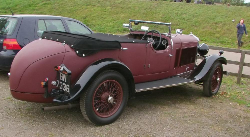

Jon, the GN registrations were certainly issued well beyond 141! There are at least two historic Roesch Talbots which were originally issued with GN numbers: the ex-Bill Esplen's Talbot 90 Brooklands was GN 5872, and the ex-Norman Pruce's 90 tourer was GN 7336
.jpg   1931 Talbot Brooklands.jpg (Size: 90.03 KB / Downloads: 564)

Jon, both Talbots were dispatched from the Works in late February, so were presumably registered at the end of February or sometime in March.
